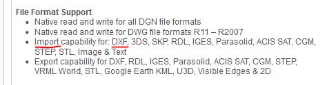

Can MicroStation import DXF files? I don't know as I do not have/use Microstation. Wait a minute I'll find out for you. I'll be back.
Well will you look at that. Seems as though MicroStation can import DXF files. Who would have guessed?
A person should know what file formats the software they are using can 1) Open, 2) Import and 3) Export.
