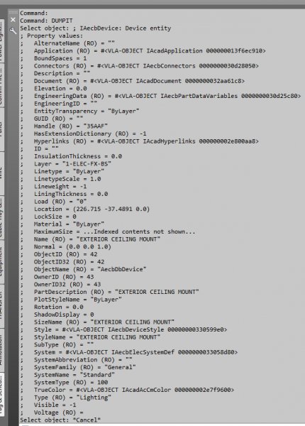

Thanks that is one gaint step closer than I was. I was hoping someone might know the variable also of the devices. I am going to run through the developer reference some more and see what I can dig up.

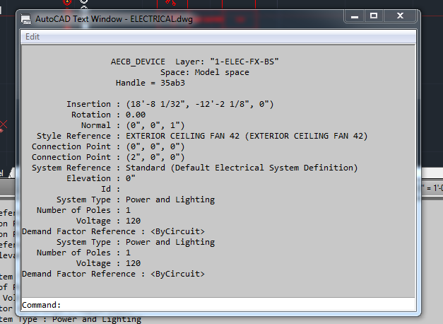

When I list the object it gives the style reference name. How is the list command getting to the data???
I attached a screen shot of the what all was included in what was returned from the list command on one of the objects.
Try this its dumpit.lsp pick your object it will give a lot more detail it will give variable names etc

The dumpit.lsp worked it was able to pull it out. The information I need is listed under Name (RO) =. I have attached a png so you can see. I need to get the string that is listed there. Is there anyway to get this data by its self? Or will I need to filter for it after I call the dumpit function?
Thanks for all the help I was beginning to think it was a lost cause. I have spent countless hours searching and reading trying to find a solution. Now I can see some light at the end of the tunnel (I JUST HOPE ITS NOT A TRAIN):shock:
It is all listed beside StyleName =
