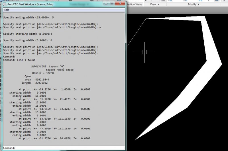

dbroada Posted October 29, 2013 Posted October 29, 2013 does that mean a polyline with various widths will show as a heavy polyline? I know I could answer myself but I am away from AutoCAD until I get to work tomorrow. Quote
Tiger Posted October 30, 2013 Author Posted October 30, 2013 Nope,, still a LWPoly. I can convert it though to a HWPoly. Quote
dbroada Posted October 30, 2013 Posted October 30, 2013 thanks Tiger, saves me the problem of remembering what I was going to do when I got in this morning. Quote
