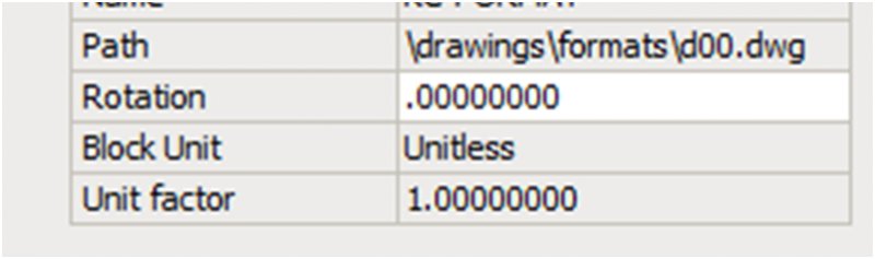

shailujp Posted November 20, 2013 Author Share Posted November 20, 2013 Here is a snap of the property manager where it lists down xref path. Quote Link to comment Share on other sites More sharing options...

shailujp Posted November 20, 2013 Author Share Posted November 20, 2013 I want to have lisp look-up somehow xref block path name and then it should decide to insert suitable another block (different name) in my drawing. Between all the xref's the only unique name I found was a file path name. I'm trying to retrieve that information somehow and store as variable and then insert another block and fill attributes and so on.... Please let me know if I'm still not making sense with this. Quote Link to comment Share on other sites More sharing options...
pBe Posted November 20, 2013 Share Posted November 20, 2013 what does this snippet show you (while (setq a (tblnext "BLOCK" (null a))) (if (assoc 1 a) (print (cdr (assoc 1 a)) ) ) ) Quote Link to comment Share on other sites More sharing options...
shailujp Posted November 21, 2013 Author Share Posted November 21, 2013 It returns this. Spot on pBe. Command: xtest "\\drawings\\formats\\b00.dwg" nil Command: Can you please explain the code? I'm thinking I dont need "while" since there will be one xref block in each drawing. Is this correct? EDIT :I tried removing while but then it started returning NIL. Now I need to find a way to use this info as a variable and set Cond for all sizes. Quote Link to comment Share on other sites More sharing options...
