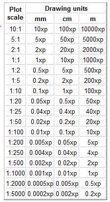

This is a list of the more commonly used plot scales for paper space metric drawings.
