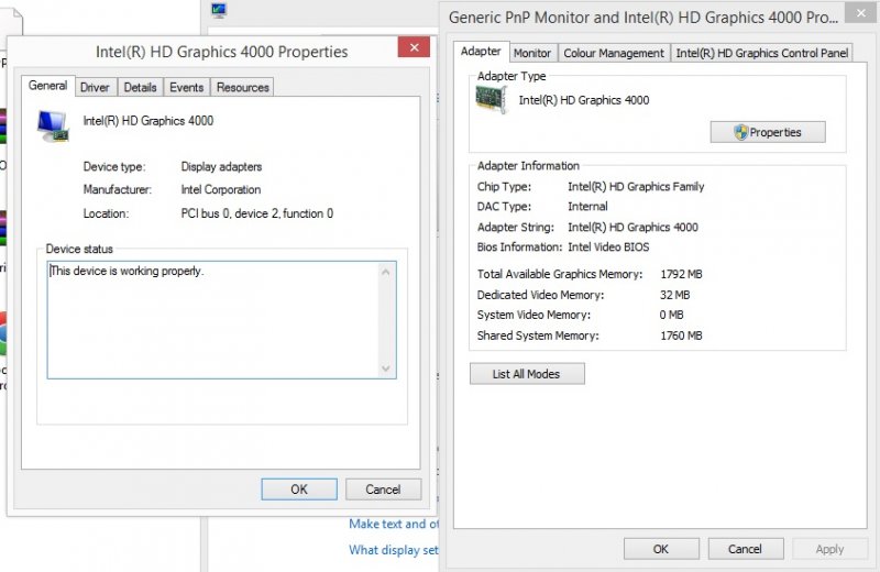

igreere Posted November 19, 2013 Author Posted November 19, 2013 Hello. Thank you for the answers. This is a 2D drawing.The file is 156 kb. The issue persists even with a brand new file. No, I use no Xrefs. I am not sure about the service packs update. I entered here http://usa.autodesk.com/adsk/servlet/ps/dl/index?linkID=9240618&id=2334435&siteID=123112#section5, but I don;t know to proceed. The video card is the following: Quote

igreere Posted November 19, 2013 Author Posted November 19, 2013 Hello. I have a HP ProBook 4740s with product no H4R00ES#ABB, on which I use Windows 8.1 64-bits. I have 6 GB of RAM installed, of which 5.88 are declared usable. Parallel to autocad I run the antivirus and the Google chrome browser. I can't say if hardware acceleration is enabled, since in Display > advanced settings I have no Troubleshooting tab. I have a monitor connected to my laptop, so I can get double screen working area. Quote
ReMark Posted November 19, 2013 Posted November 19, 2013 Re: hardware acceleration. Check 3Dconfig > manual tune. Win8.1? Is 2010 even supported on that platform? And why are you using 2010 if your Profile says 2012? Quote

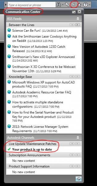

ReMark Posted November 19, 2013 Posted November 19, 2013 To check if your software is up-to-date open the CommCenter and look down near the bottom. Quote
igreere Posted November 19, 2013 Author Posted November 19, 2013 I used manual tune. Now it's far better. Sorry about the profile. I will change it immediately. Quote
igreere Posted November 19, 2013 Author Posted November 19, 2013 ok. An update is available. I will seek to it now. Quote
