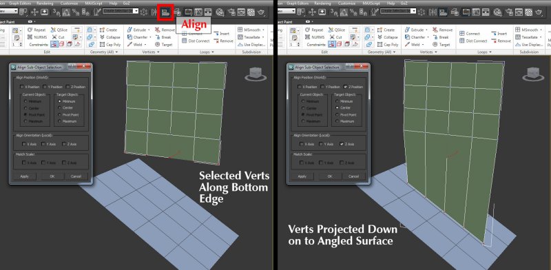

Cad64 Posted November 19, 2013 Posted November 19, 2013 A way to select certain verts and project down would be handy. What about using the Align tool? Select the verts you want to project down Click the "Align" button on your toolbar Click on the surface you want the verts to align with Set your "Align" preferences You may have to do a little tweaking afterwards, but the Align tool should get you most of the way there. Quote
spittle Posted November 19, 2013 Author Posted November 19, 2013 Thanks for the suggestion. If the lower surface is more complex then it doesn't work unfortunately. I've found a workable solution - a means to project would be better and quicker but what I did was: - select the lower edge loop of cladding (on my model there is about 30 edges hence why a means to project all of them would have been great) - extract as shape - use itoo glue plugin to glue to the 'lower surface' - it's free: http://www.itoosoft.com/freeplugins/glue.php - it will create a new spline on the lower surface. Extrude that downwards so that geo is below lower surface - called 'new surface' - select cladding, add new new surface - bridge - then delete the polys that are below the lower surface. Quote
