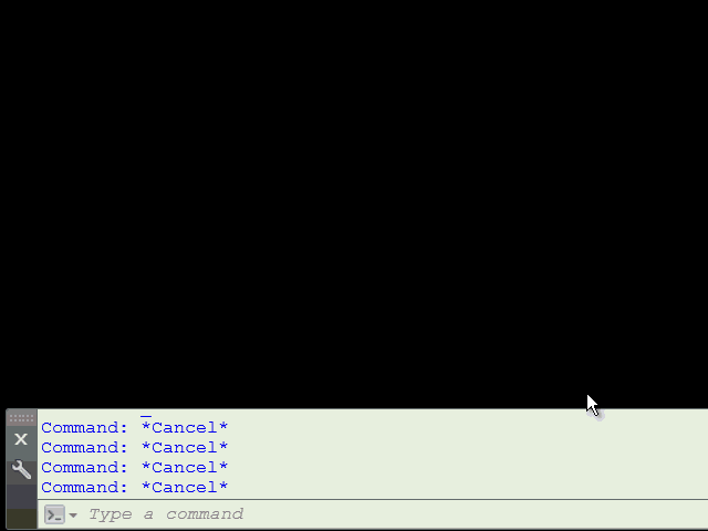

nestly Posted November 23, 2013 Share Posted November 23, 2013 Unfortunately, there is no way to do it on-the-fly without doing the math, but some of the alternatives are adjusting the UCS to match the existing line, using Copying and using Dynamic Input/Angle Change, or (IMO the easiest) ROTATE with the Copy option. see below. Quote Link to comment Share on other sites More sharing options...
