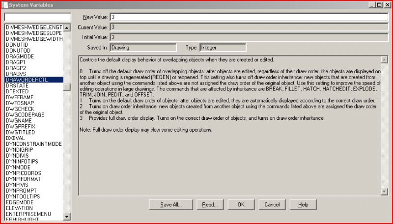

Dadgad Posted December 13, 2013 Share Posted December 13, 2013 The attached screen shot is from Autocad Vanilla, not LT, but might help to shed a little light on Draw Order behavior, and available optional settings for the DRAWORDERCTL system variable. Quote Link to comment Share on other sites More sharing options...

Tuns Posted December 13, 2013 Share Posted December 13, 2013 Why would you use that macro? It has nothing at all to do with draw order. What do you actually want to happen with the draw order anyways? I think you will find what you're looking for in Dadgad's picture that he provided. Quote Link to comment Share on other sites More sharing options...
Mase123y Posted December 13, 2013 Author Share Posted December 13, 2013 The draw order is originally based on the object creation so if you copy an object and delete the original then it moves the object to the bottom of the database and forces it to be last on the draw order. I believe that DRAWORDERCTL that Dadgad mentioned is only useful for editing/creating objects, not changing the order of existing objects but I may be wrong. Quote Link to comment Share on other sites More sharing options...
Tuns Posted December 13, 2013 Share Posted December 13, 2013 From the looks of it, you should change your DRAWORDERCTL = 2. Read the information in the picture Dadgad posted. If that variable equals 2 then any object created from another object will have the same draw order as the object it was made from if I'm understanding it correctly. Quote Link to comment Share on other sites More sharing options...
