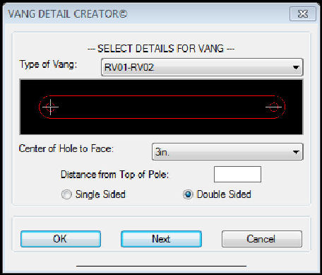

LosGirk Posted December 17, 2013 Share Posted December 17, 2013 (edited) I can't figure out how to get an image to show up in a dialog box... I've studied this code from a tutorial, but I can't figure out where are the parts I'm supposed to substitute... Wondering if someone can give me the same code back with the slide name "bolt43.sld" inserted where it needs to be? Also can you make the inserted name a different color? Thank you in advance. DCL: : image { key = "sld"; height = 30; width = 30; color = 0; is_enabled = false; is_tab_stop = false; } LSP: (setq mySlideName "c:/acad/myslide.sld") (setq myKey "sld") (upDateImage mySlideName myKey) (defun upDateImage(sldName key) (setq width (dimx_tile key)) (setq height (dimy_tile key)) (start_image key) (fill_image 0 0 width height 0) (slide_image 0 0 width height sldName) (end_image) ) Edited January 2, 2014 by SLW210 Added Code Tags Quote Link to comment Share on other sites More sharing options...
MSasu Posted December 17, 2013 Share Posted December 17, 2013 Just modify the part in magenta with your actual path: (setq mySlideName [color=magenta]"c:/acad/myslide.sld"[/color]) Please edit your post and add code tags. Quote Link to comment Share on other sites More sharing options...
Tharwat Posted December 17, 2013 Share Posted December 17, 2013 Just modify the part in magenta with your actual path: (setq mySlideName [color=magenta]"c:/acad/myslide.sld"[/color]) I wonder about the changes you made on the OP 's Image path ! This must solve the issue if the Image placed in the correct path as shown in you lisp file . DCL : DCL: dialog { : image { key = "sld"; height = 30; width = 30; color = 0; is_enabled = false; is_tab_stop = false; } ok_only; } Quote Link to comment Share on other sites More sharing options...
LosGirk Posted December 27, 2013 Author Share Posted December 27, 2013 (edited) Thanks for your replies guys, Sorry, but I'm still having trubs, I'm getting the error: No function definition: UPDATEIMAGE. Let me show you what I'm really trying to achieve- I'm trying to create a "detail builder" that will complete a detail drawing based on user picks. I'm trying to get it so that the slide matching whatever vang the user selects from the first drop down list shows up in the image area. Here's the code I have so far... // DCL CODE STARTS HERE LAD : dialog { aspect_ratio = 0; label = "VANG DETAIL CREATOR©"; fixed_height = true; fixed_width = true; : boxed_column { : text_part { label = "--- SELECT DETAILS FOR VANG ---"; alignment = centered; } : popup_list { key = "mylist1"; label = "Type of Vang:"; alignment = right; //fixed_width_font = true; width = 13; value = 0; } fixed_width = true; fixed_height = true; : image_button { alignment = top; fixed_width = true; fixed_height = true; key = "ddvp_image"; width = 55; height = 5; color = 0; is_tab_stop = false; } : popup_list { key = "mylist2"; label = "Center of Hole to Face:"; alignment = right; //fixed_width_font = true; width = 10; value = 0; } : edit_box { key = "eb1"; label = "Distance from Top of Pole:"; width = 26; fixed_width = true; value = ""; alignment = centered; } : radio_row { : spacer { width = 1; height = 0.5; } : radio_button { label = "Single Sided"; key = "B1"; alignment = centered; } : radio_button { label = "Double Sided"; key = "B2"; value = "1"; alignment = centered; } } } : boxed_column { : row { : button { label = "OK"; key = "Next"; width = 16; fixed_width = true; mnemonic = "O"; is_default = true; alignment = right; } : button { label = "Next"; key = "next"; width = 16; fixed_width = true; mnemonic = "N"; is_default = true; alignment = right; } : button { label = "Cancel"; key = "cancel"; width = 16; fixed_width = true; mnemonic = "C"; is_cancel = true; alignment = left; }} } : text_part { label = "_________________________________"; alignment = centered; } } // DCL CODE ENDS HERE ;; LISP CODE STARTS HERE (defun C:LAD() (setq myList1(list "RV01-RV02" "RV03-RV04" "RV05-RV06" "RV07-RV08" "RV09-RV10" "RV11-RV12" "RV13-RV14" "RV15-RV16" "RV17-RV18" "RV19-RV20" "RV21-RV22" "RV23-RV24" "RV25-RV26" "RV27-RV28")) (setq myList2(list "3in." "3 1/2in." "4in." "4 1/2in." "5in." "5 1/2in." "6in." "6 1/2in." "7in." "7 1/2in." "8in.")) (if(not(setq dcl_id (load_dialog "LAD.dcl"))) (progn (alert "The DCL file could not be loaded!") (exit) ) (progn (if (not(new_dialog "LAD" dcl_id)) (progn (alert "The LAD.DCL file could not be loaded!") (exit) ) (progn (start_list "mylist1" 3) (mapcar 'add_list myList1) (end_list) (start_list "mylist2" 3) (mapcar 'add_list myList2) (end_list) (fwtlogo) (action_tile "accept" "(saveVars)(done_dialog 2)") (action_tile "cancel" "(done_dialog 1)") (setq ddiag(start_dialog)) (unload_dialog dcl_id) (if(= ddiag 1) (princ "\n LAD cancelled!") ) (if(= ddiag 2) (progn (princ "\n The user pressed Okay!") ) ) ) ) ) ) (princ) ) ;; LISP CODE ENDS HERE For some reason my slide file says invalid, but here's the dwg file that a slide could be made out of. Thanks in advance for your help, and thanks for being patient! RV01-RV02.dwg Edited January 2, 2014 by SLW210 added code tags Quote Link to comment Share on other sites More sharing options...

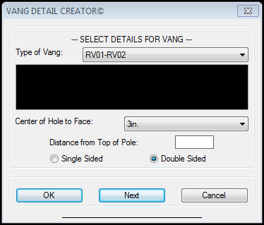

LosGirk Posted December 30, 2013 Author Share Posted December 30, 2013 Ok pBe and Tharwat, Sorry guys, I'm off to a bad start here. I've been out of the business for thirteen years, a lot of its come back to me, but there's a lot of new stuff to learn too. Thanks again for your patience. I've done my research and I think I'm ready to try this again. That having been said: Here's the original code including the logo function and the corresponding DCL. It's not the logo that gives me problems, because I know how to display vector. My problem is I don't know how to get a slide to display. I know this is stupid, but I can't figure it out! I always get the error: no function definition: UPDATEIMAGE. What I'd like to achieve in the end is to have the slide image change to reflect whatever vang type the user chooses in the pulldown above [ATTACH]46002[/ATTACH]the image area (fig. 1). I hope I've given everything you need, you guys are cool to help me, thanks. LAD : dialog { aspect_ratio = 0; label = "VANG DETAIL CREATOR"; fixed_height = true; fixed_width = true; : boxed_column { : text_part { label = "--- SELECT DETAILS FOR VANG ---"; alignment = centered; } : popup_list { key = "mylist1"; label = "Type of Vang:"; alignment = right; //fixed_width_font = true; width = 13; value = 0; } fixed_width = true; fixed_height = true; : image_button { alignment = top; fixed_width = true; fixed_height = true; key = "ddvp_image"; width = 55; height = 5; color = 0; is_tab_stop = false; } : popup_list { key = "mylist2"; label = "Center of Hole to Face:"; alignment = right; //fixed_width_font = true; width = 10; value = 0; } : edit_box { key = "eb1"; label = "Distance from Top of Pole:"; width = 26; fixed_width = true; value = ""; alignment = centered; } : radio_row { : spacer { width = 1; height = 0.5; } : radio_button { label = "Single Sided"; key = "B1"; alignment = centered; } : radio_button { label = "Double Sided"; key = "B2"; value = "1"; alignment = centered; } } } : boxed_column { : row { : button { label = "OK"; key = "Next"; width = 16; fixed_width = true; mnemonic = "O"; is_default = true; alignment = right; } : button { label = "Next"; key = "next"; width = 16; fixed_width = true; mnemonic = "N"; is_default = true; alignment = right; } : button { label = "Cancel"; key = "cancel"; width = 16; //fixed_width = true; is_cancel = true; //alignment = center; }} : column { // : row { //: boxed_column { : text_part { label = "_________________________________"; alignment = centered; } : spacer { width = 8; height = 0.0; } : image { key = "FWTlogo"; width = 11.00;// X = 42 height = 2.46;// Y = 03 fixed_width = true; fixed_height = true; aspect_ratio = 1; color = 135; alignment = centered; } } }} ;------------------------------------------------------------------------------- ; FWTlogo - FWT logo image definition for dialogs ;------------------------------------------------------------------------------- (defun FWTlogo ( ) (start_image "FWTlogo") (mapcar 'vector_image; F (list 0 0 1 2 3 4 5 7 7 8 8 8 9 9 10 10 4) (list 22 21 21 21 21 21 21 15 14 13 12 11 7 6 5 4 3) (list 5 4 5 6 7 8 9 13 13 14 14 14 17 17 18 18 18) (list 22 4 4 4 4 4 4 15 14 13 12 11 7 6 5 4 3) (list 0 0 0 0 0 0 0 0 0 0 0 0 0 0 0 0 0) );mapcar (mapcar 'vector_image; W (list 20 20 20 21 22 23 24 18 18 18 25 26 26 26 26 31 31 31 32 33 34 36 32 33 34 35 36) (list 22 21 20 20 20 20 20 5 4 3 15 15 17 18 20 15 13 16 14 11 8 13 22 22 22 22 22) (list 24 24 18 19 20 21 22 22 22 22 30 31 32 32 33 34 35 31 32 33 34 40 41 42 43 44 45) (list 22 21 6 6 6 6 6 5 4 3 3 3 3 3 3 6 14 17 20 18 16 4 3 3 3 3 3) (list 0 0 0 0 0 0 0 0 0 0 0 0 0 0 0 0 0 0 0 0 0 0 0 0 0 0 0) );mapcar (mapcar 'vector_image; T (list 47 47 48 49 50 51 52 46 46 45 45 44) (list 22 21 21 21 21 21 21 3 4 5 6 7) (list 52 51 52 53 54 55 56 61 61 61 60 60) (list 22 4 4 4 4 4 4 3 4 5 6 7) (list 0 0 0 0 0 0 0 0 0 0 0 0) );mapcar (vector_image 61 3 32 21 1); / (end_image) );defun FWTlogo ;----------------------------------------------------------------------------- ; MAIN ;----------------------------------------------------------------------------- (defun C:LAD() (setq myList1(list "RV01-RV02" "RV03-RV04" "RV05-RV06" "RV07-RV08" "RV09-RV10" "RV11-RV12" "RV13-RV14" "RV15-RV16" "RV17-RV18" "RV19-RV20" "RV21-RV22" "RV23-RV24" "RV25-RV26" "RV27-RV28")) (setq myList2(list "3in." "3 1/2in." "4in." "4 1/2in." "5in." "5 1/2in." "6in." "6 1/2in." "7in." "7 1/2in." "8in.")) (if(not(setq dcl_id (load_dialog "LAD.dcl"))) (progn (alert "The DCL file could not be loaded!") (exit) ) (progn (if (not(new_dialog "LAD" dcl_id)) (progn (alert "The LAD.DCL file could not be loaded!") (exit) ) (progn (start_list "mylist1" 3) (mapcar 'add_list myList1) (end_list) (start_list "mylist2" 3) (mapcar 'add_list myList2) (end_list) (fwtlogo) (action_tile "accept" "(saveVars)(done_dialog 2)") (action_tile "cancel" "(done_dialog 1)") (setq ddiag(start_dialog)) (unload_dialog dcl_id) (if(= ddiag 1) (princ "\n LAD cancelled!") ) (if(= ddiag 2) (progn (princ "\n The user pressed Okay!") ) ) ) ) ) ) (princ) ) Quote Link to comment Share on other sites More sharing options...
