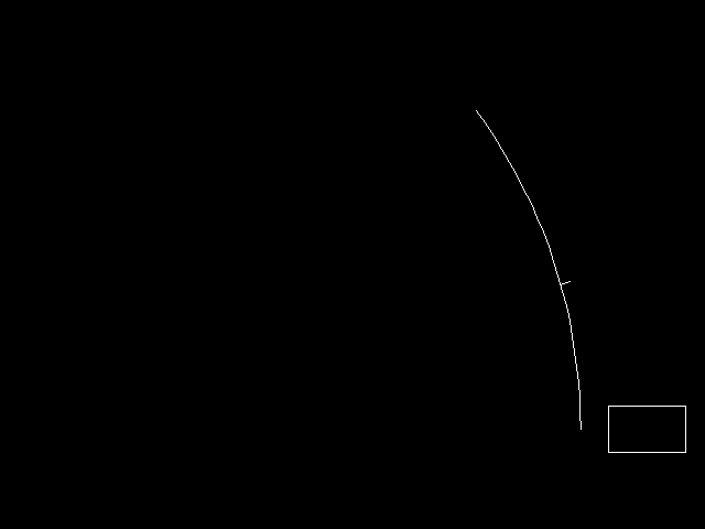

nestly Posted December 17, 2013 Posted December 17, 2013 A frequent task I need to do is Rotate/Copy an object to specific points around the perimeter of an arc/circle, and the best way I've found is to use Rotate with the [C]opy and [R]eference options, however this is a bit tedious particurally on large diameter arcs. I've written a macro to automatically activate the Copy and Reference options, but I still have to pick the rotation basepoint, (center of arc), then repick the same point for the first reference point, then the 2nd reference point, and finally the destination point. What I would like is some help making a macro or lisp that automatically uses the Rotate basepoint as the first reference point, and then repeats so I can pick multiple destinations without re-issuing the command and re-selecting the arc center as a basepoint. My current procedure is demonstrated below. Any help would be much appreciated, thanks Quote

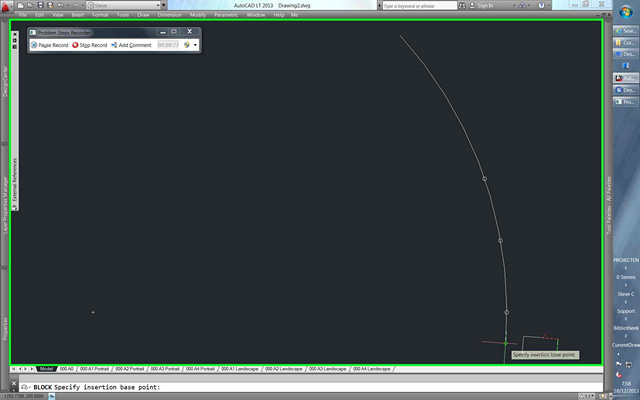

steven-g Posted December 17, 2013 Posted December 17, 2013 I would imagine you actually create more than 2 copies, if so would it not be an option to create a block from your object with its base point on the curve, and then use either the divide or measure commands with the option of placing and aligning the block at the required points. (I did a video but it came out at 16MB so you will have to make do with a sketchy description ) Quote

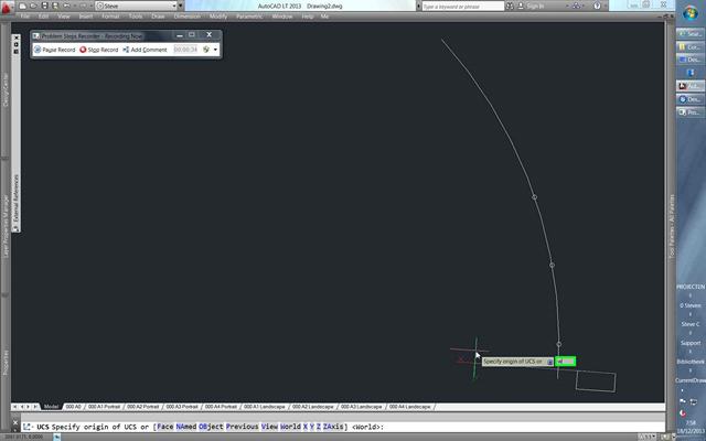

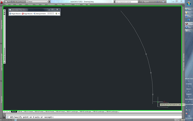

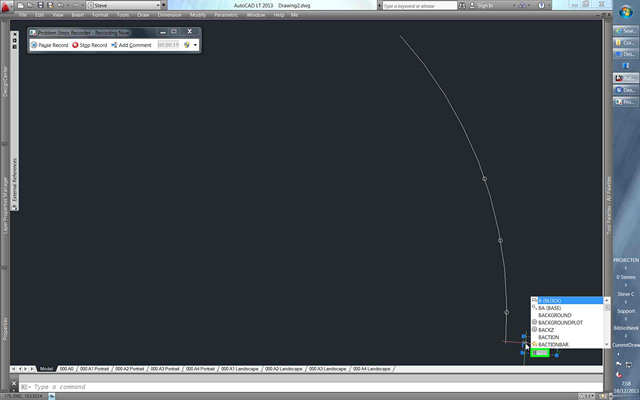

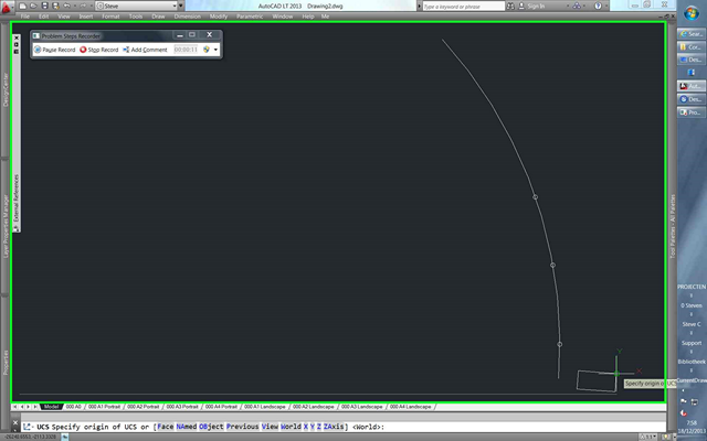

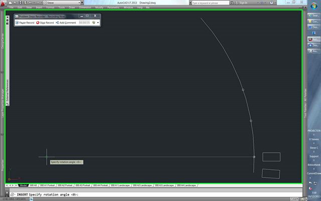

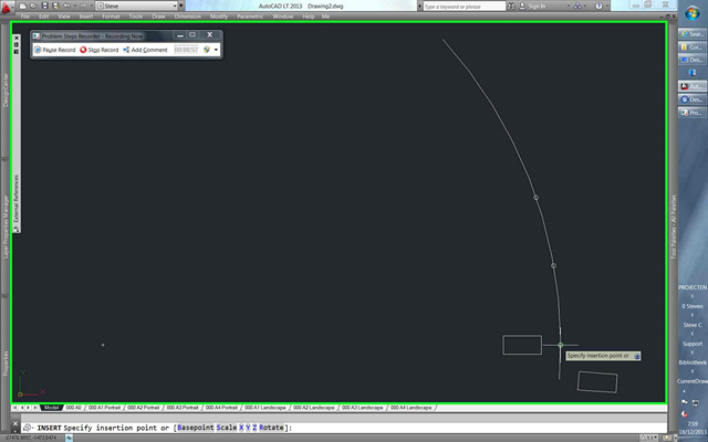

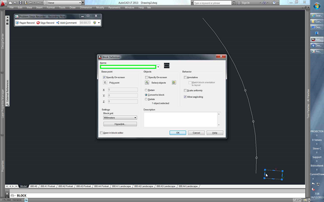

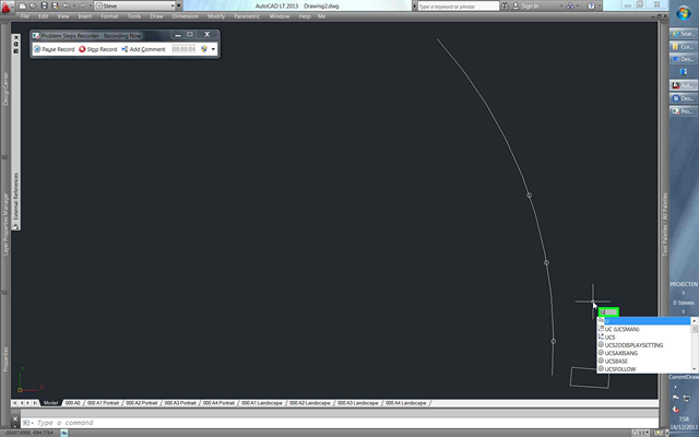

steven-g Posted December 18, 2013 Posted December 18, 2013 Back to the block method, you ned to change the UCS so that the insert point is on the +ve X side of the block, select the object as your block and the base point on your arc. Switch UCS back to world and insert with the options to pick insertion point and rotation on screen, insert point is on your arc and rotate to the centre of the arc each time. Quote

steven-g Posted December 18, 2013 Posted December 18, 2013 And here is a macro that lets you change the UCS to align to the object, select the object, creates a block called "a", lets you pick the insertion point resets the UCS to world and then starts the insert command, prompts for the insert point for the original object again, and the rotation point is the centre of the arc. ^C^CUCS;\\;select;\-block;a;\ucs;w;insert;a;\;; Quote
