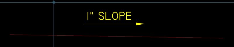

Tuns Posted December 19, 2013 Posted December 19, 2013 Well, I'm not sure what the standard is over there, but if we label something like that here it would look like 3"∅ X 5'-0" STEEL STRUCTURAL PIPE W/ 1/4" SLOPE Of course that is only an example because I don't know the actual dimensions. That should be how it should look I would think. You may need to leave off the slope part of that label and put it above the pipe itself and also put an arrow to show which direction it slopes like in the picture below. Quote

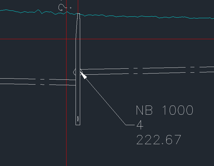

Tiger Posted December 20, 2013 Posted December 20, 2013 (edited) Shouldn't be that hard to create a label with that information, all the information is there on the pipe, it's just a matter of accessing it. If you're still here and interested, can you send me an example of your file? And no, ReMark is not the standard of this forum. Sorry that your first run-in was with him. Update: Something like this? Edited December 20, 2013 by Tiger Quote

Tiger Posted December 20, 2013 Posted December 20, 2013 The Settings tab, under Pipe and/or Structure and Label Style. THere you can acess the label styles that you have in your drawing. Double click on one of them, on the Layout-tab you find a Contents-row. Click the three dots and you can decide what info you want to show. It's a bit trial and error after that, at least for me to get the right info displayed. Quote
