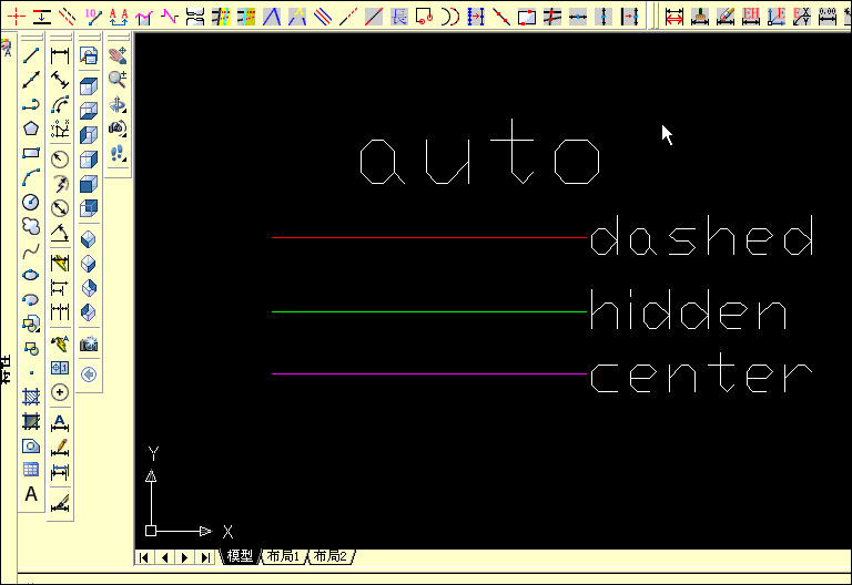

lucas3 Posted January 1, 2014 Share Posted January 1, 2014 (edited) Change a linear scale by region, why have err? Parameter type error:stringp (8 . "0") (defun c:TT (/ e d el lay lt l nls ss) (if (and (setq ss (ssget)) ;_Do not choose Continuous (setq d (getdist "\nSpecifies the length : ")) ;_ ) (progn (setq nls (getvar "ltscale")) (repeat (setq n (sslength ss)) (setq e (ssname ss (setq n (1- n))) el (entget e) lay (assoc 8 el) ) (if (not (setq lt (cdr (assoc 6 el)))) ; (setq lt (cdr (assoc 6 (tblsearch "layer" lay)))) ; ) (setq l (cdr (assoc 40 (tblsearch "ltype" lt)))) ;_ (vl-catch-all-apply 'vlax-put-property (list (vlax-ename->vla-object e) 'LinetypeScale (/ d l nls)) ) ) ) ) (princ) ) (princ "\nCommand:TT") Edited January 2, 2014 by lucas3 Quote Link to comment Share on other sites More sharing options...

lucas3 Posted January 2, 2014 Author Share Posted January 2, 2014 I know that a lisp can change "individual object ltscale" & "overall ltscale" ,but my idea is different from this, I want: 1.multi-select(region) 2.Input the scaling factor or Automatic judgment。 ;;; dynamic by qjchen@gmail.com ;;; The mail idea come from eachy master: http://eachy.bokee.com/5731665.html ;;; http://www.xdcad.net/forum/showthread.php?postid=1534283 (defun C:test ( / dcl_id dclcontent dclname userclick temp) (vl-load-com) (setq temp (getvar "cmdecho")) (setvar "cmdecho" 0) (command "undo" "be") (setq dclcontent (list "qjchenedynamicltscale:dialog{" "label=\"dynamic linetype scale modify by qjchen\";" ":button{" "key = \"button1\";" "label = \"individual object ltscale\";}" ":button{" "key = \"button2\";" "label = \"overall ltscale\";}" "ok_cancel;}") dclname "qjchendltscale" ) (setq dcl_id (load_dialog (qjchencreatdcl dclname dclcontent))) (if (not (new_dialog "qjchenedynamicltscale" dcl_id)) (exit)) (action_tile "button1" "(done_dialog 3)") (action_tile "button2" "(done_dialog 4)") (setq userclick (start_dialog)) (unload_dialog dcl_id) (cond ((= 3 userclick)(qjchenedltscale 1)) ((= 4 userclick)(qjchenedltscale 2)) ) (command "undo" "e") (setvar "cmdecho" temp) ) (defun qjchenedltscale(n / a b gr linetype newscale o orilst overallltscale zq) (prompt "\n Please select one not continuous linetype object:") (setq a (car (entsel)) o (vlax-ename->vla-object a)) (setq orilst (vlax-get-property o 'LinetypeScale)) (setq linetype (cdr (assoc 6 (entget a)))) (if (= linetype nil) (setq linetype (cdr (assoc 6 (tblsearch "layer" (cdr (assoc 8 (entget a))))))) ) (if (and linetype (/= linetype "Continuous")) (progn (setq zq (cdr (assoc 40 (tblsearch "ltype" linetype)))) (setq overallltscale (getvar "LTSCALE")) (setq b (getpoint "\nSelect one point:")) (while (= (car (setq gr (grread nil 5 0))) 5) (redraw) (grdraw (cadr gr) b 1 1) (setq newscale (/ (distance (cadr gr) b) zq overallltscale)) (apply-props o (list (list "LinetypeScale" newscale))) ) (if (= n 2) (progn (setvar "ltscale" (* overallltscale (/ newscale orilst))) (apply-props o (list (list "LinetypeScale" orilst))) (command "regen") ) ) ) ) (vlax-release-object o) (princ) ) ;;from dave theswamp (defun apply-props (object proplist) (foreach prop proplist (if (vlax-property-available-p object (car prop)) (vlax-put-property object (car prop) (cadr prop)) ) ) ) (defun qjchencreatdcl(dclname lst) (setq dcl_name (strcat (getenv "temp") "\\" dclname ".dcl") f (OPEN dcl_name "w") ) (foreach x lst (write-line x f) ) (close f) dcl_name ) ;;end main program (princ "\n By qjchen@gmail.com, dynamic linescale, The command is test") (princ) Quote Link to comment Share on other sites More sharing options...

Tharwat Posted January 2, 2014 Share Posted January 2, 2014 How does the lisp routine determine on its own (automatic judgement) what the linetype scale for any particular object should be? It could be with this lisp Be SURE to have the selected lines on any hidden Ltypes to see the changes . (defun c:Test (/ ss l n e) ;; Tharwat 02.01.2014 ;; (if (and (setq ss (ssget "_:L" '((0 . "*LINE")))) (setq l (getdist "\n Specify Line Type Scale :"))) (repeat (setq n (sslength ss)) (setq e (entget (ssname ss (setq n (1- n))))) (entmod (append e (list (cons 48 l)))) ) ) (princ) ) Quote Link to comment Share on other sites More sharing options...

lucas3 Posted January 2, 2014 Author Share Posted January 2, 2014 Yes, sometimes things get lost in translation. Unfortunately that cannot be helped. That is why I asked for more details and/or a drawing. Sorry but I cannot open your attachment. GIF photo is reupload thank! Quote Link to comment Share on other sites More sharing options...
lucas3 Posted January 2, 2014 Author Share Posted January 2, 2014 It could be with this lisp Be SURE to have the selected lines on any hidden Ltypes to see the changes . (defun c:Test (/ ss l n e) ;; Tharwat 02.01.2014 ;; (if (and (setq ss (ssget "_:L" '((0 . "*LINE")))) (setq l (getdist "\n Specify Line Type Scale :"))) (repeat (setq n (sslength ss)) (setq e (entget (ssname ss (setq n (1- n))))) (entmod (append e (list (cons 48 l)))) ) ) (princ) ) Thank you very much !Tharwat ,very good ! Automatically adjust the linear scale,can do ? look this photo: Quote Link to comment Share on other sites More sharing options...
Tharwat Posted January 2, 2014 Share Posted January 2, 2014 Thank you very much !Tharwat ,very good ! Automatically adjust the linear scale,can do ? look this photo: Does it mean that you are satisfied with the routine or what ? Quote Link to comment Share on other sites More sharing options...
lucas3 Posted January 2, 2014 Author Share Posted January 2, 2014 Does it mean that you are satisfied with the routine or what ? Thank you ! Tharwat ,You answered my question correctly!If can automatically adjust will be better (defun c:Test (/ ss l n e) ;; Tharwat 02.01.2014 ;; (if (and (setq ss (ssget "_:L" '((0 . "*LINE")))) (setq l (getdist "\n Specify Line Type Scale :"))) (repeat (setq n (sslength ss)) (setq e (entget (ssname ss (setq n (1- n))))) (entmod (append e (list (cons 48 l)))) ) ) (princ) ) Can you add "After picking up the line,Displays the current linear scale value in Command Bar" ? so when I change ,I have a Reference value Quote Link to comment Share on other sites More sharing options...
Tharwat Posted January 2, 2014 Share Posted January 2, 2014 Thank you ! Tharwat ,You answered my question correctly!If can automatically adjust will be better You're welcome . Can you add "After picking up the line,Displays the current linear scale value in Command Bar" ? so when I change ,I have a Reference value This ... ? (defun c:Test (/ ss l n e) ;; Tharwat 02.01.2014 ;; (if (and (setq ss (ssget "_:L" '((0 . "*LINE")))) (setq l (getdist "\n Specify Line Type Scale :"))) (repeat (setq n (sslength ss)) (setq e (entget (ssname ss (setq n (1- n))))) (entmod (append e (list (cons 48 l)))) ) ) (if l (princ (strcat "\n Ltype value: " (rtos l 2)))) (princ) ) Did you receive my Private Message ? Quote Link to comment Share on other sites More sharing options...
lucas3 Posted January 3, 2014 Author Share Posted January 3, 2014 You're welcome . This ... ? (defun c:Test (/ ss l n e) ;; Tharwat 02.01.2014 ;; (if (and (setq ss (ssget "_:L" '((0 . "*LINE")))) (setq l (getdist "\n Specify Line Type Scale :"))) (repeat (setq n (sslength ss)) (setq e (entget (ssname ss (setq n (1- n))))) (entmod (append e (list (cons 48 l)))) ) ) (if l (princ (strcat "\n Ltype value: " (rtos l 2)))) (princ) ) Did you receive my Private Message ? Hi!Tharwat , It is not,Command bar shows the modified values ,I mean: apload test.lisp ,run"test" ,Pick up the line ,Spaces or Enter, command bar display:The current linear scale is:**,Specify Line Type Scale : Quote Link to comment Share on other sites More sharing options...
Tharwat Posted January 3, 2014 Share Posted January 3, 2014 This ... ? (defun c:Test (/ ss n e) ;; Tharwat 02.01.2014 ;; (if (and (progn (princ "\n Select any kind of lines to change the LType scale ..." ) (setq ss (ssget "_:L" '((0 . "*LINE")))) ) (princ (strcat "\n Current Ltype scale of last objects < " (if *ltsv* (rtos *ltsv* 2) "0.0" ) " > " ) ) (setq *ltsv* (getdist "\n Specify Line Type Scale :")) ) (repeat (setq n (sslength ss)) (setq e (entget (ssname ss (setq n (1- n))))) (entmod (append e (list (cons 48 *ltsv*)))) ) ) (princ) ) (princ) (princ "\n** Type < Test > to invoke the command **") (princ) Quote Link to comment Share on other sites More sharing options...
