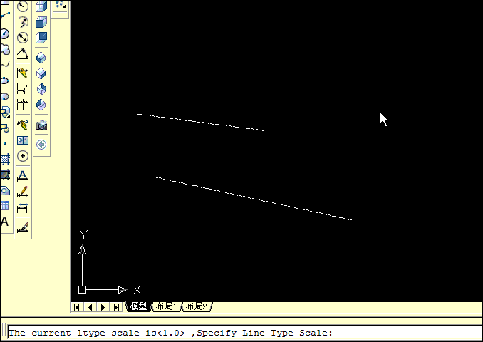

This ... ?
(defun c:Test (/ ss n e)
 ;;    Tharwat 02.01.2014    ;;
 (if
   (and (progn
          (princ
            "\n Select any kind of lines to change the LType scale ..."
          (setq ss (ssget "_:L" '((0 . "*LINE"))))
        (princ (strcat "\n Current Ltype scale of last objects < "
                       (if *ltsv*
                         (rtos *ltsv* 2)
                         "0.0"
        (setq *ltsv* (getdist "\n Specify Line Type Scale :"))
    (repeat (setq n (sslength ss))
      (setq e (entget (ssname ss (setq n (1- n)))))
      (entmod (append e (list (cons 48 *ltsv*))))
(princ "\n** Type < Test > to invoke the command **")
NO!not last ,before changes,scale is 1.0 , so when Select the object,Command bar display: "The Current Ltype scale Specify Line Type Scale : If I change to 0.5,so the current ltype scale is 0.5,next time when use this command ,Command bar display:"The Current Ltype scale Specify Line Type Scale :

Hi,Tharwat ,other ,this code not support pline
Hi!,Tharwat ,Your help was greatly appreciated. Can you understand what I mean ?(#21)
Hi!Tharwat ,I mean: when Select line ,Read and display The value of figure in the red box, ( figure is here: http://url.cn/Px3TOa )
when Single Choice no problem,when multi-select, if the value of linetype scale is the same , so display it ,if the value of linetype scale is different,so display “*multifarious*”
NOW ,Do you understand?
This code by Free-Lancer (http://bbs.xdcad.net/)
ltype scale.lsp
app.lsp Must change expanded-name to app.fas,Because,Can't upload *.fas file
app.lsp
I think the fas file have some function
Hi !Tharwat, This is what I want ! but must appload app.fas file ! now, you Should be understand what I want, Can you help me finish it ?I'm truly grateful for your help

(defun c:abcd()
(vl-load-com)
(setq acadobject (vlax-get-acad-object))
(setq acaddocument (vla-get-activedocument acadobject))
(setq mspace (vla-get-modelspace acaddocument))
(setq ss (ssget))
(setq i -1 flag t flag1 t)
(setq aa (ssname ss 0))
(setq vlaa (vlax-ename->vla-object aa))
(setq first (vla-get-LinetypeScale vlaa))
(repeat (sslength ss)
 (setq aa (ssname ss (setq i (1+ i))))
 (if (= first (vla-get-LinetypeScale vlaa))
   (setq flag t)
   (setq flag1 nil)
(if (and flag flag1)
 (setq gg (getreal (strcat "The current ltype scale is :" (RTOS first 2) ",Specify Line Type Scale :")):")))
 (setq gg (getreal (strcat "The current ltype scale is :*multifarious* ,Specify Line Type Scale :")):" )))
(setq i -1)
 (vla-put-LinetypeScale vlaa gg)

On ‎1‎/‎2‎/‎2014 at 4:09 PM, Tharwat said:
It could be with this lisp ;)
Be SURE to have the selected lines on any hidden Ltypes to see the changes .
(defun c:Test (/ ss l n e)
 (if (and (setq ss (ssget "_:L" '((0 . "*LINE")))) (setq l (getdist "\n Specify Line Type Scale :")))
     (entmod (append e (list (cons 48 l))))
