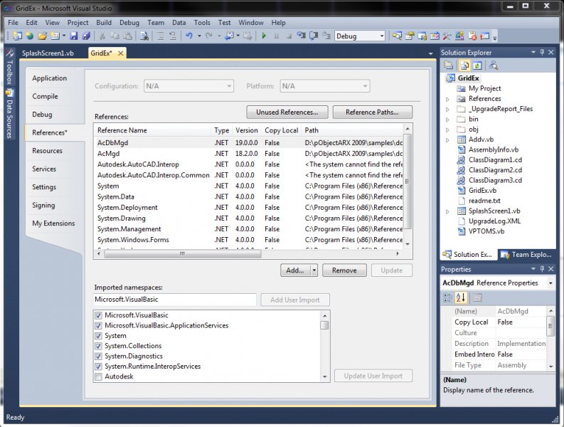

Jozi68 Posted January 16, 2014 Author Share Posted January 16, 2014 I'm not sure what code to post, I have a few thousand lines in there. However, I suspect the first problem is a setting somewhere. I'm including a screenshot: I really hope this helps. Quote Link to comment Share on other sites More sharing options...
BlackBox Posted January 16, 2014 Share Posted January 16, 2014 I'm not sure what code to post, I have a few thousand lines in there. However, I suspect the first problem is a setting somewhere. I'm including a screenshot:[ATTACH=CONFIG]46318[/ATTACH] I really hope this helps. Thanks for the screenshot (everything seems okay), but without (even anonymized?) code to look at, I'm lost as to how anyone might begin to help you with: In Civil3D, I type in "Netload", find the dll that was built, and type in one of my commands. Nothing happens. Maybe I should be doing something else at this point, I don't know. I really would like to step through my code. ... In fact, all I can do at this point, is to direct you toward this DevBlog article as a simple example of how to implement a successful CommandMethod Method. HTH Quote Link to comment Share on other sites More sharing options...
