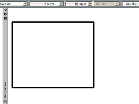

tom111 Posted January 3, 2014 Share Posted January 3, 2014 Dear all, Happy New Year Please can you advise how I can calculate room areas accurately. I can't snap to the internal faces of the thick polylines. Does anyone have a solution to this? I attach a snippet of the rooms. Thanks tom111 area example.dwg Quote Link to comment Share on other sites More sharing options...
Tiger Posted January 3, 2014 Share Posted January 3, 2014 Math-solution: Calculate area based on the OSnap-points that you do have - remove the area of the walls. or half the area of the walls if you need the rooms. CAD-solution: un-thicken the lines, do a offset on them (300 to each side for the thick ones) to get lines on the outer edge of the polyline and then measure the area. Quote Link to comment Share on other sites More sharing options...

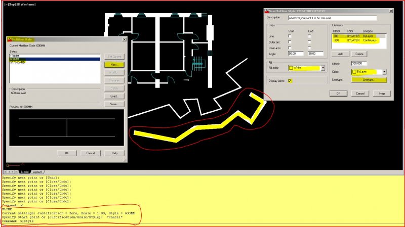

Dadgad Posted January 3, 2014 Share Posted January 3, 2014 Bit of a sticky wicket there Tom. As you have no doubt noticed that the only grips and osnaps you will find on a polyline are all at the center of it. I don't do architectural, but you might want to consider creating some custom Multiline styles to represent your typical wall thicknesses. Quote Link to comment Share on other sites More sharing options...
Tiger Posted January 3, 2014 Share Posted January 3, 2014 Multiline... I always forget that there are Multilines as well to use. that should give you the snappoints that you need fairly quickly. Put them on their own layer so you can easly get rid of them later. Quote Link to comment Share on other sites More sharing options...
tom111 Posted January 3, 2014 Author Share Posted January 3, 2014 Thanks everyone. Multiline is something I've not used before. Is this available in LT? Nothing happens when I change the polyline line thickness. If I explode the polyline then it reduces the line thickness, and I can do things with it then. Quote Link to comment Share on other sites More sharing options...
Dadgad Posted January 3, 2014 Share Posted January 3, 2014 Thanks everyone. Multiline is something I've not used before. Is this available in LT? Nothing happens when I change the polyline line thickness. If I explode the polyline then it reduces the line thickness, and I can do things with it then. You should be able to change thickness of the polyline in PROPERTIES, or as shown in QUICK PROPERTIES. Lineweight settings are different than Polyline widths. I have never used LT, but should expect that you would have MULTILINE capability. Quote Link to comment Share on other sites More sharing options...
nestly Posted January 3, 2014 Share Posted January 3, 2014 I'm also not an architectural guy, but I don't think it's common practice to use a wide polyline in the center of the wall. My observation is that lines, polylines, or multilines are drawn to represent wall edges. Also just wanted to point out that Lineweight and Linewidth are different properties. Quote Link to comment Share on other sites More sharing options...
Dadgad Posted January 3, 2014 Share Posted January 3, 2014 Should you want to explore Multilines, you can call the MLSTYLE command which will get you the dialog box to select or create a new style. I created 2, one for a 150mm wall and one for a 600mm wall. There are lots of cool options. You select NEW, and start from STANDARD style, after which you can set justification, distances between them, linetypes, filled or not. Once you have created one, you just drag it around, you can see that I have created 2 rather random walls by just defining the points. A great tool which is probably under utilized. Multiline styles can have a bunch of elements (is it 7?) in each one, with mixed linetypes and colors. Sort of like a 2D version of the POLYSOLID command, which is good for drawing 3D walls. Quote Link to comment Share on other sites More sharing options...
