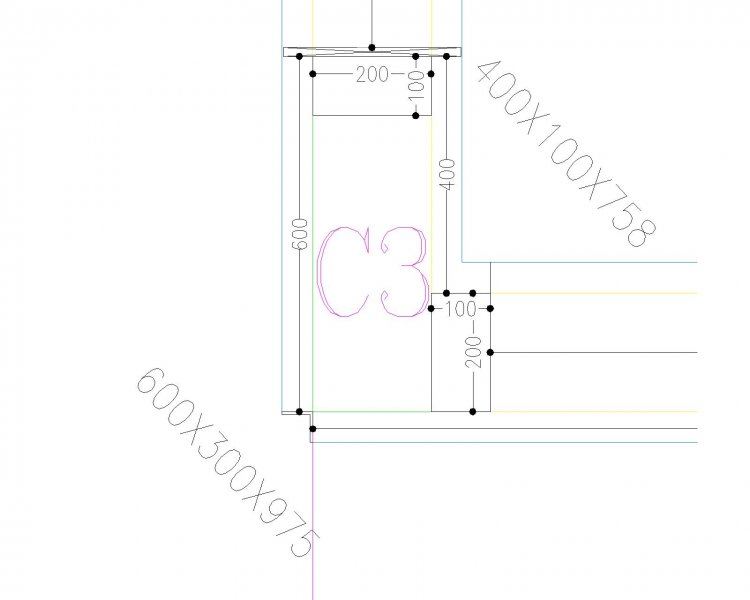

when I use insert command: I; I select DimPC from the drop down list. But, when I pull is text don't auto alignment.
Image attach:
Thank you very much.
How about this one
Thank steven-g very much!
It's great, I noticed that the gap has changed automatically when dragging dimensions. No need to use the REGEN command. Very intuitive when drawing.
The last thing, more difficult to describe in words. That is, the first two of the dimensions we choose to modify it to pull the whole block instead of just pulling the two ends of the dimension.
First arrowhead of dimension don't fixed when edited (drag, move)
Please view the video to compare the two using.
Please, help me fixed.
https://www.youtube.com/watch?v=Z8b2WqCKc5c
Thank steven-g!
Nice video, I have looked about and tried a few things, but this looks a bit too much for dynamic blocks to handle, the only way I can see this working is to go back to inserting blocks into a dim style arrow, but that means a different style for each block.
Dir, steven-g
Final, I am very grateful for your help!
I will move into my new article directory AutoLisp to suit the purpose of the forum. We wish the help of steven-g in the near future.
Good luck for steven-g.
I wish you well, Yes Lisp may provide you with the help you need, unfortunately that is not available in LT so I can't assist with that, I hope you can find the solution.

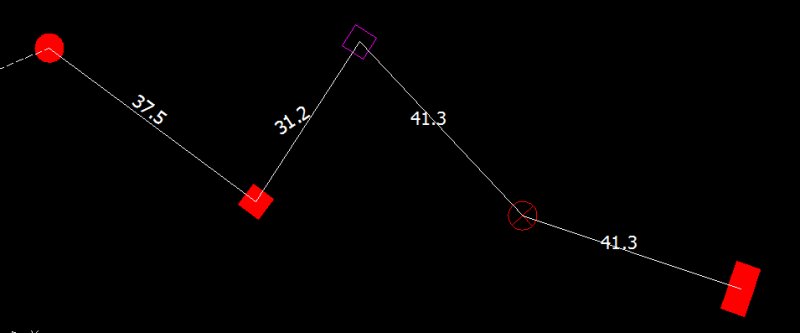

I need a need program... to survive my task.
when i dimensioned the lines, the measurement value should be aligned dimesion and attributed as text.
file:///C:/Documents%20and%20Settings/Owner/Desktop/123.jpg
Good morning,
I want a lisp to the following attached purpose and it should be in the pattern of below.
continuing to dimaligned, the measurement value to be attributed as deafault.
