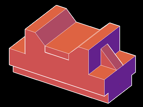

raynelockyer Posted January 6, 2014 Share Posted January 6, 2014 Alright so I have to subtract that little box inside the guide block so it looks like this http://gyazo.com/bc7fdf0552af580344d665e45127b2db I have no idea how to do this.. Thanks:? exploded version guideblock.dwg Quote Link to comment Share on other sites More sharing options...

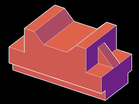

raynelockyer Posted January 6, 2014 Author Share Posted January 6, 2014 help? I need it to look like this http://gyazo.com/4a26b7a06d83f3beee3b9a5ab92c7128 but i can't subtract the middle of it angel brackel bad.dwg Quote Link to comment Share on other sites More sharing options...
nestly Posted January 6, 2014 Share Posted January 6, 2014 Are you selecting the objects in the right order? SUBTRACT Select object to subtract from Select object to subtract Alternately, on this object you could simply PRESSPULL the surface 6 units to get the same result. Quote Link to comment Share on other sites More sharing options...
nestly Posted January 6, 2014 Share Posted January 6, 2014 SUBTRACT Select object to subtract from Select object to subtract http://www.cadtutor.net/forum/showthread.php?83806-I-can-t-subtract-this-block Quote Link to comment Share on other sites More sharing options...
raynelockyer Posted January 6, 2014 Author Share Posted January 6, 2014 Thank you so much. I did the Subtract the same way you showed me but it wasn't working. The presspull did work though Quote Link to comment Share on other sites More sharing options...

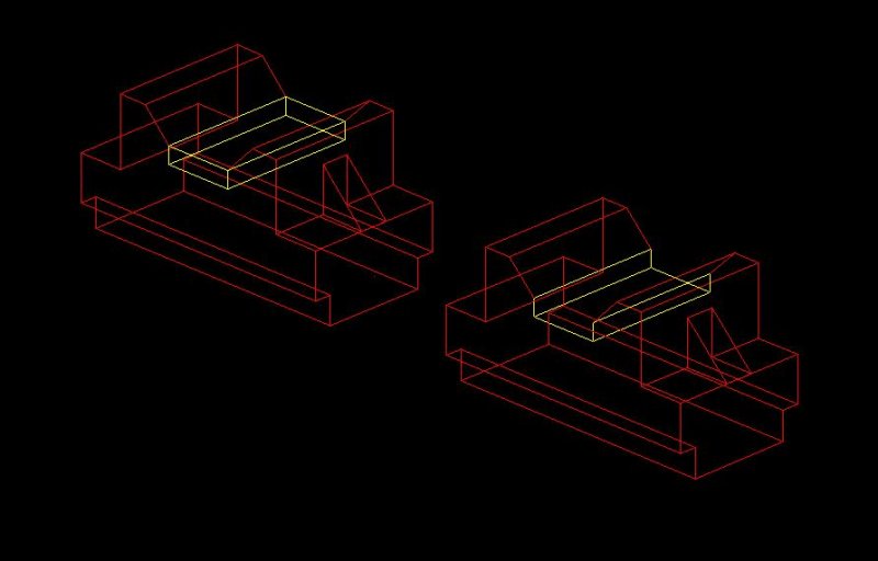

ReMark Posted January 6, 2014 Share Posted January 6, 2014 Fortunately there is nothing to prevent one from using the SUBTRACTION command on the geometry that was created. Some users will encounter problems because they 1) do not pay close attention to what AutoCAD is asking in the command line prompts and 2) are working in something other than a 2Dwireframe visual style which can, on occasion, make selecting objects problematic. Let's investigate both. The following image demonstrates the "before" and "after" of the subtraction process as done in a 2Dwireframe visual style. For the purposes of this demonstration the block to be subtracted has had its color changed to yellow. Execution of the SUBTRACT command is as follows: Command: _subtract Select solids, surfaces, and regions to subtract from .. Select objects: 1 found Select objects: Select solids, surfaces, and regions to subtract .. Select objects: 1 found Note that AutoCAD asks us to first indicate the object we are subtracting from. In our case it is the red colored object. Then it prompts us for the object to subtract. In our case it is the yellow colored object. The process is completed and the results are as shown in the above image. Quote Link to comment Share on other sites More sharing options...
ReMark Posted January 6, 2014 Share Posted January 6, 2014 I believe that you are not quite following what you are being prompted to do on the command line when you use the SUBTRACT command. This appears to be the same problem you were having in another thread you posted. Always select the object you are subtracting from first followed by the object you want to subtract. In this case the first object would be the guide block while the second object would be the extruded rectangle at its base. Give it a try. Quote Link to comment Share on other sites More sharing options...
