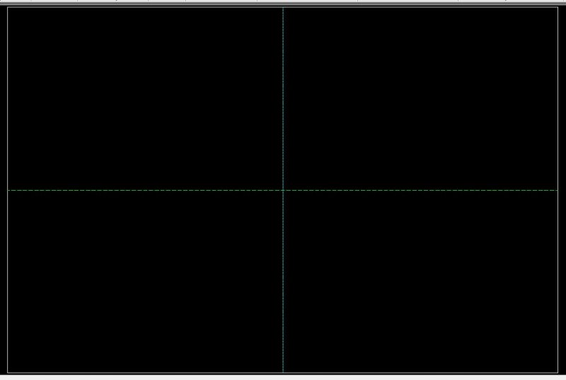

ReMark Posted January 6, 2014 Posted January 6, 2014 An image of a drawing (24x36) with two lines in it. The horizontal green line has a linetype of HIDDEN. The vertical cyan line has a linetype of HIDDEN2. The template file is imperial and the lines are drawn at full size. Could you erase everything in your drawing with the exception of one of the lines you are having a problem with, save it under a different name, and attach that to a subsequent post? Remember to first save your present drawing before doing this. Quote

rkent Posted January 6, 2014 Posted January 6, 2014 Do not use the ACAD_ISO.... linetypes, load the ones that say HIDDEN, CENTER, etc. Quote
ReMark Posted January 6, 2014 Posted January 6, 2014 See where it says Linetype in your Properties? Why doesn't that say "ByLayer"? Is it a company practice to use ACAD_ISO02W100 linetype for a dashed line? If so then your linetype scale shouldn't be "1"; it should be something like 0.1 or 0.05. Quote
ReMark Posted January 6, 2014 Posted January 6, 2014 The above lines use the ACAD_ISO02W100 linetype. The top line is 13 inches long. The bottom line is 22 inches long. For the line to appear dashed it would have to be a minimum of 15 inches long. Quote
Evelynn Posted January 6, 2014 Author Posted January 6, 2014 Yeah, the only reason I used the ACAD_ISO linetype, is because it's the dashed line that popped up first (I didn't realize there were more options, for some reason). It's not company policy. I just did it erroneously So, knowing now that I should use "Hidden" linetypes, how do I change the existing ACAD_ISO lines over to "Hidden" lines? I'd hate to have to redraw them all. Quote
ReMark Posted January 6, 2014 Posted January 6, 2014 Open your Layer Properties Manager and assign either the HIDDEN or HIDDEN2 linetype to the layer these types of lines will appear on. This assumes you have created a layer for your hidden lines. The ACAD_ISO linetypes tend to be used more in drawings done to metric units. Quote
