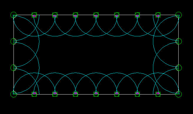

ymg3 Posted January 15, 2014 Posted January 15, 2014 Suriwaits, Here is the routine modified to allow for underspray. Better, but there are still Zone where the overspray/underspray will go to 1.5 meter. I've added a test function, if you issue TEST as a command, a table over the range 5m. to 40 m. will be generated and printed on the text screen. (defun round (x) (if (>= (- x (fix x)) 0.5) (1+ (fix x)) (fix x))) (defun dtr (a) (* pi (/ a 180.0))) (defun rtd (a) (/ (* a 180.0) pi)) ;;; listpol by Gille Chanteau ; ;;; Returns the vertices list of any type of polyline (WCS coordinates) ; ;;; ; ;;; Argument ; ;;; en, a polyline (ename or vla-object) ; (defun listpol (en / i p l) (setq i (+ (vlax-curve-getEndParam en) (if (vlax-curve-IsClosed en) 1 0))) (while (setq p (vlax-curve-getPointAtParam en (setq i (1- i)))) (setq l (cons (trans p 0 1 ) l)) ) ) ;; sprktyp ; ;; ; ;; Argument: d Length of Side To Install Sprinklers. ; ;; Return: A list (Spacing "Type" HDnum Overspray) ; (defun sprktyp (d / hdnum hdtyp head headl ovspr ovtmp radius rtn) (setq headl '((4.572 . "15-180")(3.658 . "12-180")(3.048 . "10-180")) ovspr 99999 ) (foreach head headl (setq radius (car head) hdtyp (cdr head) hdnum (round (/ d radius)) ovtmp (abs (- (* hdnum radius) d)) spacing (/ d hdnum) ) (if (< ovtmp ovspr) (setq ovspr ovtmp rtn (list spacing hdtyp hdnum ovspr) ) ) ) rtn ) (defun c:spr ( / a cb d d1 d2 enl n oldsnap p1 pl s1b s2b ss) (setq oldsnap (getvar 'OSMODE)) (setvar 'OSMODE 0) (prompt "\nSelect The Zone To Cover With Sprinklers:") (if (setq ss (ssget "_:S" '((-4 . "<or")(0 . "*POLYLINE")(0 . "CIRCLE")(-4 . "or>")))) (progn (setq enl (entget (ssname ss 0))) (cond ((= (cdr (assoc 0 enl)) "CIRCLE") (princ "\nNot Implemented Yet.")) (t (setq pl (listpol (ssname ss 0)) p1 (car pl) pl (cdr pl) d1 (distance p1 (car pl)) d2 (distance (car pl) (cadr pl)) s1b (sprktyp d1) s2b (sprktyp d2) cb (strcat (itoa (max (atoi (cadr s1b)) (atoi (cadr s2b)))) "-90") ) (repeat 2 (vl-cmdf "_INSERT" cb p1 "" "" (rtd (setq a (angle p1 (car pl))))) (setq n 1) (while (< (setq d (* n (car s1b))) d1) (vl-cmdf "_INSERT" (cadr s1b) (polar p1 a d) "" "" (rtd a)) (setq n (1+ n)) ) (setq p1 (car pl) pl (cdr pl)) (vl-cmdf "_INSERT" cb p1 "" "" (rtd (setq a (angle p1 (car pl))))) (setq n 1) (while (< (setq d (* n (car s2b))) d2) (vl-cmdf "_INSERT" (cadr s2b) (polar p1 a d) "" "" (rtd a)) (setq n (1+ n)) ) (setq p1 (car pl) pl (cdr pl)) ) ) ) ) ) (setvar 'OSMODE oldsnap) (princ) ) (defun c:test () (setq d 5.0) (textscr) (princ "\nD \tSpc\tTYP\tHD#\t OVSpray") (while (< d 40.1) (setq typ (sprktyp d)) (princ (strcat "\n" (rtos d 2 1) "\t" (rtos (car typ) 2 2) "\t" (cadr typ) "\t" (itoa (caddr typ)) "\t" (rtos (cadddr typ) 2 2))) (setq d (+ d 0.1)) ) (princ) ) Quote
suriwaits Posted January 16, 2014 Author Posted January 16, 2014 (edited) Thanks. Apppreciate your efforts. Command: Spr not working, it just ask the user to select object. after that nothing, command just ends. Command: test list the table for various distance. As the distance goes beyond 20m, 15' will be the easy choice in practical but your calculation select for 10-180, then 12-180 and 15-180 in sequence and then changes again. i think you did not notice my calc in the excel file i have attached before, so i am attaching it again. It consists simple mathematical function. I guess we can implement the same funcion in lisp. I don't mind inputting radius rather than automatically selecting the radius, it will give the user more control over selection. Please note that 15', 12', 10' are the max radius limit i want to use, this can be reduced to to a 25% max. by manufacturer recommendation. That is the reason i have the limit like 4-4.5m, 3.1-3.6m, 2.5-3.0m. This is what i am requesting, forget about what i asked earlier. 1. Ask the user to select a line or poly line, and enter the radius required. if the entered radius in not in the range of 4-4.5,3.1-3.6, 2.5-3.0. Give error message "Not in range. Try Smaller Series Nozzles manually" 2. Ask the user to select (Exact spacing / Best Fit), for exact spacing use measure command with the radius entered for best fit, use divide command by calculating no of segments based on calc in the excel attached. (Block selection, if input radius is between 4-4.5 (15-180), 3.1-3.6 (12-180) & 2.5-3.0 (10-180)) Suriwaits, Here is the routine modified to allow for underspray. Better, but there are still Zone where the overspray/underspray will go to 1.5 meter. I've added a test function, if you issue TEST as a command, a table over the range 5m. to 40 m. will be generated and printed on the text screen. Sprinkler.xlsx Edited January 16, 2014 by suriwaits Quote
ymg3 Posted January 16, 2014 Posted January 16, 2014 (edited) Suriwaits, I've just tested taken the code from the page and it works for me. Of course you need a drawing with your block already defined. I did notice your calculations. Please refrain from quoting the whole previous post this is wasteful, and we can refer to the previous post easily. If I test for 90 meters distance: (sprktyp 90.0) (4.5 "15-180" 20 1.44) This means 4.5 meters spacing between heads, Type 15-180 is selected, 20 spaces on this side, Overspray/Underspray is 1.44 meters. This is what i am requesting, forget about what i asked earlier. Your tone seems a little aggressive there. ymg sprinkler.dwg sprinkler.LSP Edited January 16, 2014 by ymg3 Quote

ymg3 Posted January 16, 2014 Posted January 16, 2014 Suriwaits, I am not Gille, I am ymg As told before there is not much error trapping in the routine. To work it must be a polyline and be drawn from Lower Left to Upper Right. Once we are OK with the head selection we can add more error trapping and let the routine works no matter the orientation. First test it and let me know. ymg Quote

ymg3 Posted January 16, 2014 Posted January 16, 2014 suriwaits, Here I have added the Circular Zone. (defun round (x) (if (>= (- x (fix x)) 0.5) (1+ (fix x)) (fix x))) (defun dtr (a) (* pi (/ a 180.0))) (defun rtd (a) (/ (* a 180.0) pi)) ;;; listpol by Gille Chanteau ; ;;; Returns the vertices list of any type of polyline (WCS coordinates) ; ;;; ; ;;; Argument ; ;;; en, a polyline (ename or vla-object) ; (defun listpol (en / i p l) (setq i (+ (vlax-curve-getEndParam en) (if (vlax-curve-IsClosed en) 1 0))) (while (setq p (vlax-curve-getPointAtParam en (setq i (1- i)))) (setq l (cons (trans p 0 1 ) l)) ) ) ;; sprktyp ; ;; ; ;; Argument: d Length of Side To Install Sprinklers. ; ;; Return: A list (Spacing "Type" HDnum Overspray) ; (defun sprktyp (d / hdnum hdtyp head headl ovspr ovtmp radius rtn) (setq headl '((4.572 . "15-180")(3.658 . "12-180")(3.048 . "10-180")) ovspr 99999 ) (foreach head headl (setq radius (car head) hdtyp (cdr head) hdnum (round (/ d radius)) ovtmp (abs (- (* hdnum radius) d)) spacing (/ d hdnum) ) (if (< ovtmp ovspr) (setq ovspr ovtmp rtn (list spacing hdtyp hdnum ovspr) ) ) ) rtn ) (defun c:spr ( / a cb d d1 d2 enl n oldsnap p1 s1b s2b ss) (setq oldsnap (getvar 'OSMODE)) (setvar 'OSMODE 0) (prompt "\nSelect The Zone To Cover With Sprinklers:") (if (setq ss (ssget "_:S" '((-4 . "<or")(0 . "*POLYLINE")(0 . "CIRCLE")(-4 . "or>")))) (progn (setq enl (entget (ssname ss 0))) (cond ((= (cdr (assoc 0 enl)) "CIRCLE") (setq pc (cdr (assoc 10 enl)) rd (cdr (assoc 40 enl)) perim (* 2 pi rd) typ (sprktyp perim) ang (/ (* 2 pi) (caddr typ)) p1 (polar pc 0 rd) a 0 ) (repeat (caddr typ) (vl-cmdf "_INSERT" (cadr typ) (polar pc a rd) "" "" (+ (rtd a) 90)) (setq a (+ a ang)) ) ) (t (setq pl (listpol (ssname ss 0)) p1 (car pl) pl (cdr pl) d1 (distance p1 (car pl)) d2 (distance (car pl) (cadr pl)) s1b (sprktyp d1) s2b (sprktyp d2) cb (strcat (itoa (max (atoi (cadr s1b)) (atoi (cadr s2b)))) "-90") ) (repeat 2 (vl-cmdf "_INSERT" cb p1 "" "" (rtd (setq a (angle p1 (car pl))))) (setq n 1) (while (< (setq d (* n (car s1b))) d1) (vl-cmdf "_INSERT" (cadr s1b) (polar p1 a d) "" "" (rtd a)) (setq n (1+ n)) ) (setq p1 (car pl) pl (cdr pl)) (vl-cmdf "_INSERT" cb p1 "" "" (rtd (setq a (angle p1 (car pl))))) (setq n 1) (while (< (setq d (* n (car s2b))) d2) (vl-cmdf "_INSERT" (cadr s2b) (polar p1 a d) "" "" (rtd a)) (setq n (1+ n)) ) (setq p1 (car pl) pl (cdr pl)) ) ) ) ) ) (setvar 'OSMODE oldsnap) (princ) ) (defun c:test (/ d typ) (setq d 5.0) (textscr) (princ "\nD \tSpc\tTYP\tHD#\t OVSpray") (while (< d 40.1) (setq typ (sprktyp d)) (princ (strcat "\n" (rtos d 2 1) "\t" (rtos (car typ) 2 2) "\t" (cadr typ) "\t" (itoa (caddr typ)) "\t" (rtos (cadddr typ) 2 2))) (setq d (+ d 0.1)) ) (princ) ) Quote
suriwaits Posted January 17, 2014 Author Posted January 17, 2014 suriwaits, Here I have added the Circular Zone. Works very well. It would be great, you could please alter the code instead of Over spray, under spray upto 20%, eg 10' max radius is 3.1 and min radius is (3.1-0.2*3.1)=2.48, for 12' max radius is 3.7 and min radius is 3.11, similarly for 15', max radius is 4.6 and min is 3.71. Also, for the rectangular area, i would like the code to compare to between vertical direction and horizontal direction, select minimum of these two (eg i have 42x3.2m, as code select 15-180 for 42m side, 12-90 for 3.2m side instead i want to compare which is min, place 12series sprinklers with the distance as required for 12 series). i don't know this is practically possible in all cases. Thanks Suriwaits Quote

suriwaits Posted January 18, 2014 Author Posted January 18, 2014 Wondering myself when the OP will realize that condition, and that is the item I've been waiting on all this time ymg I realized the reason you were trying to explain. That's why i have changed the range 2.48-3.1 for 10', 3.101 to 3.7 for 12' and 3.701 to 4.6 for 15' in Post #33. With this new condition i think it will work for almost for all except lines with less than 2.48m length. The reason i am sticking with this is because you cannot a adjust 15' sprinkler to 17' in field, 12' to 13' . Since it is the max. radius. But you can reduce to 20% of max radius. Quote
ymg3 Posted January 18, 2014 Posted January 18, 2014 suriwaits, Look at the Excel sheet. I gave you the minimum for all types of heads. The spread goes to as high as 1.52 meter. What does that tell you ? Now if you want to change it for your range be my guest! ymg Quote
suriwaits Posted January 18, 2014 Author Posted January 18, 2014 (edited) suriwaits, Look at the Excel sheet. The spread goes to as high as 1.52 meter ymg Sorry for being such a pain. Ur concept of selecting sprinkler is good. But when the segment length exceeds 24m. any length can be divided into multiples of 15' (3.7-4.6m), hence no need to select small radius even though which is more perfect match as per your calculation. eg. for 25m, 6 segments, radius 4.17, 15-180 26m, 7 segments, radius 3.71, 15-180 27m, 7 segments, radius 3.86, 15-180 28m, 7 segments, radius 4, 15-180 Please look at the excel i have attached. My first preference is 15' (so i try 3.701) find no of segments by calcuating quotient (segment length, 3.701), find Remainder by calcualting Mod (segment length, 3.701) new radius is 3.701+(rem/3.701) , if this is less than 4.6, go ahead with 15-180. other wise try with 12' find no of segments by calcuating quotient (segment length, 3.101), find Reminder by calcualting Mod(segment length, 3.101) new radius is 3.101+(rem/3.101) , if result is less than 3.7, go ahead with 12-180. otherwise try with 10' find Reminder by calcualting Mod(segment length, 2.4) new radius is 2.48+(rem/2.4), if result is less than 3.1, go ahead with 10-180. otherwise give alert msg " not in range", and exit the command. I googled & found some equivalenet lisp (?) function for this. But i don't know how to use this in code. Please help me on this. Function: quotient x y Divide integer x by integer y; return an integer quotient and discard the remainder. If x or y is negative, the direction of rounding is undefined. Function: idiv x y Perform an integer division; if x and y are both nonnegative integers, this uses the quotient function, otherwise it computes `floor(x/y)'. Thus the result is well-defined but slower than for quotient. Function: imod x y Divide integer x by integer y; return the integer remainder and discard the quotient. Like quotient, this works only for integer arguments and is not well-defined for negative arguments. For a more well-defined result, use `(% x y)'. Function: idivmod x y Divide integer x by integer y; return a cons cell whose car is `(quotient x y)' and whose cdr is `(imod x y)'. calc.xlsx Edited January 18, 2014 by suriwaits Quote
