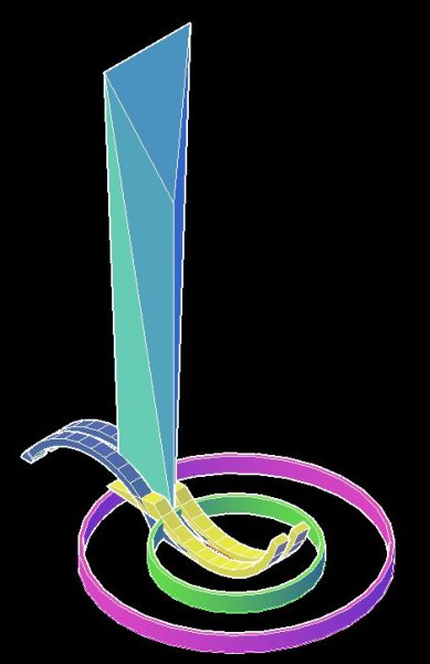

ReMark
Very interesting concept. Not that I fully understand it in its entirety but I see lots of potential. Anyway, my idea would be to trace over as much of your original design using closed polylines or 3Dpolylines and reproduce the model as a solid. Something similar to what is shown below. Each color represents a different layer.
I wasn't quite sure what you were attempting to do at the back of the structure so I did not proceed any further. If you care to explain it to me I'd make the necessary additions then upload/attach a copy of the drawing if you were interested. If not, that's OK. No offense will be taken. I'll just consign the file to the recycle bin.

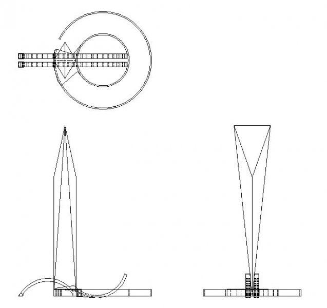

ReMark
Karuga: Does this work for you?

Karuga
Wow that looks amazing! Because I have never done anything 3D in AutoCAD before (I normally play with baby toys like SketchUp, shame I know), I must admit I have hardly any idea what you are talking about with the 3D poly-lines and meshes.
How did you come to this final ortho? The remaining hiccup is that I will have to delete lines that wouldn't be visible (they are behind other faces) and replace them with dotted lines, but my poor 3D AutoCAD skills aren't about to let me do that. Are the faces in this ortho just the original 3D model rotated and lined up? Or are they 2D drawings now? If they are 2D could you please describe the process so I can try and learn it?

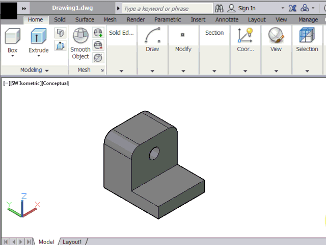

nestly
Here's a demo and a summary of commands that should do if you're only interested in obtaining the ortho views
Explode the blocks
Use QSELECT to select all the Polyface Meshes and isolate them ( I move them away from the rest of the model )
Explode the remaining blocks (2x)
Use QSELECT to select the remaining Polyface Meshes and isolate them (move using the same displacement as previous)
Use MESHSMOOTH to convert the Polyface Meshes into "regular" Meshes
Adjust the view to represent what you want to project using the ViewCube
Use FLATSHOT to project the Meshes onto a single Plane and place the block
Adjust the view for the next projection and use FLATSHOT, returning to "Top View" before placing the block
Adjust the view for additional projections as needed and use FLATSHOT, remembering to always return to "Top View" to place the block

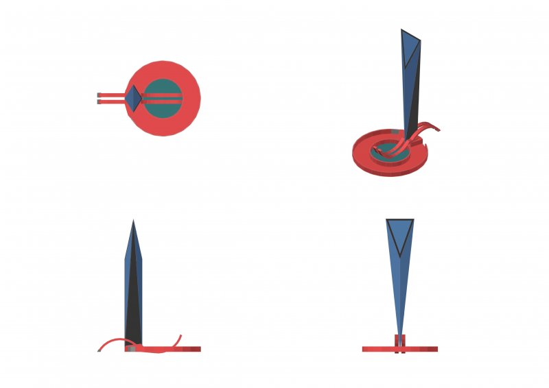

gazza_au
Go to paper space, create 4 x view ports on a new layer with printer icon turned off.
select view and view style in each window.

ReMark
Karuga: I have not viewed nestly's video but I'm sure you should have no trouble following it which means you won't be using my method. However, I'll still try to answer your question as best I can.
How did you come to this final ortho? After recreating your model as a series of solids I used the View Base command. This is one of a handful of commands that will extract 2D views of 3D models. The 2D views are automatically constructed in a paper space layout not in model space.
Re: dotted lines. Also referred to as "hidden" lines. Maybe it is difficult to see in the posted image but lines that are hidden from view are shown where required, again automatically, as dashed. There is no need for the user to manually replace continuous lines with dashed lines.

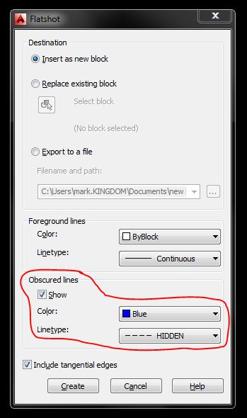

ReMark
I finally got a chance to watch nestly's video and the only thing I suggest you do differently is enable Show Obscured lines. I suggest using either the Dashed or Hidden linetype and to make the lines stand out visually I would pick a contrasting color like blue or black.
