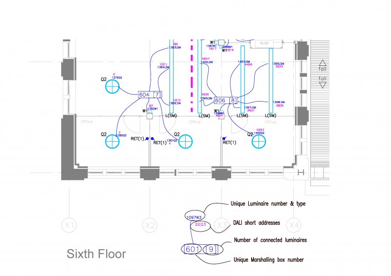

Calon Posted January 21, 2014 Author Posted January 21, 2014 Here is an example of the kind of thing I'm working towards. The Unique luminaire numbers can be of any format, those shown are for example. The DALI address corresponds to our controls addressing which has to be done manually. Theres too many catches and alternatives and different protocols to attempt to include this yet. I have found a way of placing incrimental luminaire numbers over a provided reflected ceiling plan. Up to now i have been manually drawing on the marshalling boxes and connecting appropriate luminaires to the marshalling boxes. I am just trying to see if it is possible to have a situation whereby after a maximum of 8 luminaires are placed a marshalling box pops in automatically. If this is not possible with LISP, I have a plan for how to do this with visio but I'd like to avoid this if there is a possibility of extending the functionality within the CAD suite. Quote
AONE_LED Posted 22 minutes ago Posted 22 minutes ago Don't try to insert a marshalling box the instant an eighth luminaire is placed. Place and number all luminaires first, then run a LISP that: (1) lets you select a group, or automatically clusters fixtures into groups of eight; (2) inserts the network-box block at the group's centroid or at a point you pick on the control route; (3) draws a polyline from the box to each luminaire in the group; (4) writes luminaire number, box number and a running count to a CSV for your BOM. Keep the "maximum 8 lamps per box" as a parameter, not hard-coded, because some boxes take fewer. DALI itself allows up to 64 short addresses on one bus; the eight-lamp limit is a wiring/marshalling constraint, not a protocol limit. That split keeps the drawing step and the takeoff step reliable. Quote
