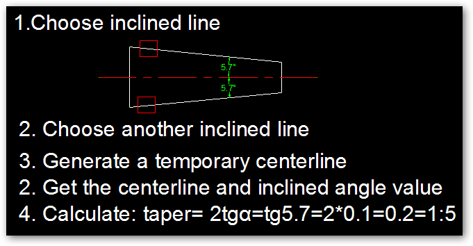

lucas3 Posted February 17, 2014 Author Share Posted February 17, 2014 (edited) vimcruz, #40 has been updated,If only choose a line for dimension,It's not accurate,Sometimes the drawing are not horizontal(level) dimension slope ,can choose datum line and the reference line When dimension taper,choose what? Knotty!Hope more people involved, give some advice. Edited February 17, 2014 by lucas3 Quote Link to comment Share on other sites More sharing options...
vimcruz Posted February 18, 2014 Share Posted February 18, 2014 (edited) vimcruz, #40 has been updated,If only choose a line for dimension,It's not accurate,Sometimes the drawing are not horizontal(level)[ATTACH=CONFIG]46950[/ATTACH] dimension slope ,can choose datum line and the reference line When dimension taper,choose what? Knotty!Hope more people involved, give some advice. I noticed that, since I'm not considering rotation of the object I was miscalculating the distance between points. Anyhow, in this update (v2.1.1) that has been fixed and works as it should. The downside...look at the Change Log: ;; -Change Log- ;; ;; > v2.1.1 ;; ;; - Math for point distance fixed ;; ;; - [b][color="red"]Entity to dim must be exploded (separated in[/color][/b] ;; ;; [b][color="red"]lines[/color][/b]) ;; ;; - Underline of data adjusted to reach text ;; ;; length ;; ;; - Fixed: rotated object bug ;; ;; - Added: function VC:GetTextLength in order to ;; ;; know how far the text goes ;; ;;-------------------------------------------------;; slope_v2.1.1.lsp Edited February 18, 2014 by vimcruz Quote Link to comment Share on other sites More sharing options...

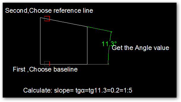

lucas3 Posted February 19, 2014 Author Share Posted February 19, 2014 I tried,About pick up, still has problem!Method is not correct As this picture,how dimension ? I think like this: Quote Link to comment Share on other sites More sharing options...
vimcruz Posted February 19, 2014 Share Posted February 19, 2014 Add the extra lines to make the triangle needed then use the slope function. At least while I think something out Quote Link to comment Share on other sites More sharing options...
lucas3 Posted February 19, 2014 Author Share Posted February 19, 2014 The same,when dimension taper ,can like this: Quote Link to comment Share on other sites More sharing options...
MSasu Posted February 19, 2014 Share Posted February 19, 2014 Add the extra lines to make the triangle needed then use the slope function. At least while I think something out Vimcruz, you may want to check the INTERS built-in function that will allow you to get the said triangle - please consider setting the onseg argument to nil to ensure that intersection is found even when lines don't actually physically intersect. (inters pt1 pt2 pt3 pt4 [color=blue]onseg[/color]) Quote Link to comment Share on other sites More sharing options...
lucas3 Posted February 19, 2014 Author Share Posted February 19, 2014 Add the extra lines to make the triangle needed then use the slope function. At least while I think something out Using the trigonometric function is a must (Tangent function) Quote Link to comment Share on other sites More sharing options...
MSasu Posted February 19, 2014 Share Posted February 19, 2014 Lucas3, I think that Vimcruz had suggested you there a workaround - to temporary extend the lines and use the existing slope option until he will fix the tool. Quote Link to comment Share on other sites More sharing options...

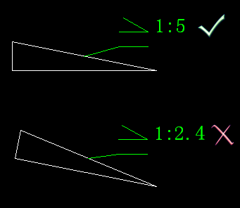

lucas3 Posted February 20, 2014 Author Share Posted February 20, 2014 Thanks msasu,and thanks vimcruz, Thank you for your effort! I think I chose the wrong project Why? I tried it , slope value is not very precise ? Quote Link to comment Share on other sites More sharing options...

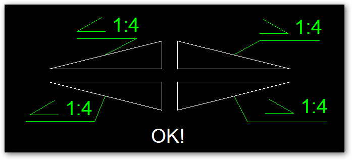

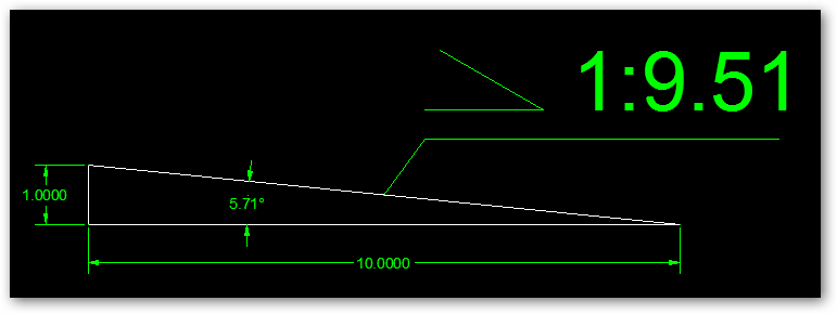

vimcruz Posted February 20, 2014 Share Posted February 20, 2014 Thanks msasu,and thanks vimcruz, Thank you for your effort! Why? I tried it , slope value is not very precise ? [ATTACH=CONFIG]47021[/ATTACH] The wrong project cause I just started learning lisp like 2 weeks ago, so, it's hard haha. About the precision, maybe caused by the rounded angle: 135. (if (>= ang (+ (fix ang) 0.5)) ;Round the angle . (setq ang (1+ (fix ang))) . (setq ang (fix ang)) . ) (setq m (abs (tan ang)) ratio (/ 1.0 m) percent (* 100 m) 144. ) Now is fixed (changed the order). Anyhow, I think the slope function has a high precision, since it takes the angle and evaluates through the trigonometric functions. I tested it and it works fine now. slope_v2.1.3.lsp Quote Link to comment Share on other sites More sharing options...

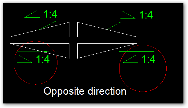

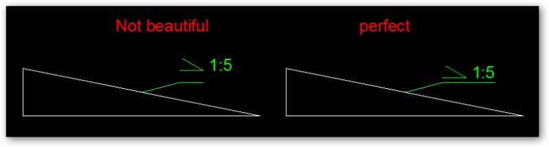

lucas3 Posted February 21, 2014 Author Share Posted February 21, 2014 Dear vimcruz , Found the problem again Symbol,opposite direction,look Lead also has a problem,Not beautiful! Should be like this: Quote Link to comment Share on other sites More sharing options...
