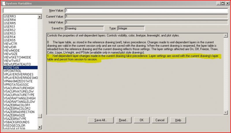

moatt Posted February 6, 2014 Share Posted February 6, 2014 I've spent days searching for the answer to this question, and I've had no luck. I have my base plan (which has all layers overlapping each other) XREF'd into my sheet file. I freeze unnecessary layers out of the sheet file and everything is perfect. When I need to make changes I prefer to use REFEDIT to edit the XREF from the sheet file, but sometimes my layers all become visible again. Sometimes they retain their visibility. It seems to be a per drawing variable, not a system wide variable, but I can't discover which variable it is. It's definitely not VISRETAIN. I can't work in the confusing jumble of overlapping layers (hence why I prefer to use REFEDIT in the first place) and it is seriously impeding my work productivity. Does anyone know what I can do? Thanks so much. Quote Link to comment Share on other sites More sharing options...

RobDraw Posted February 20, 2014 Share Posted February 20, 2014 Okay, I'll try but your question is not exactly clear, so a couple answers are necessary. Also, let me preface this with that I do not use REFEDIT to edit my XREFs. I tried it once or twice but did not like it. I don't remember why, though. Is the layer state you are referring to within the XREF while in REFEDIT or in the sheet file? Is it possible that REFEDIT is picking up whatever state that the XREF is in? VISRETAIN is the variable that controls how a file handles the XREF layers. What setting are you using? Quote Link to comment Share on other sites More sharing options...
moatt Posted February 20, 2014 Author Share Posted February 20, 2014 Thank you so much. Let me clarify: I open the sheet file. Double click on the xref to open it in REFEDIT. It's the same XREF, but different sheet files. In some sheet files the layer visibility stays the same in the REFEDIT as it was in the sheet file. In some sheet files the layer visibility reverts to what it is in the XREF. I can't determine why some sheet files are reacting differently. I've worked in firms where XREF's are only used for things like titleblocks and the main drawings are in the sheet files. In those files you look in model space and it's a crazy jumble of overlapping madness. But you work in paperspace so you can control layer visibility and make it workable. I've worked in firms where the base files are XREF's, but the dimensions, electrical, notes, mechanical, etc are all drawn in the sheet files. In those files you can work in model space because all the of the confusing jumble of stuff is spread out amongst the sheet files. This firm they put everything...and I mean EVERYTHING...in the base files. Then XREF it into the sheet files. The only thing in the sheet files is an XREF in modelspace and a titleblock in paperspace. The only way I can make sense of it is to work in the sheet files and use REFEDIT. But a few weeks ago it started acting funny, where the layer visibility doesn't stay how it was in the sheet file. The only way I can work in it is every single time I have to change something I open the XREF through REFEDIT and go through freezing all of the layers (which takes about 5-10 minutes). Once it's workable I do my work and then I save it and close the REFEDIT. But if I have to open it again I have to go through and freeze it all again. When it works correctly, I don't have to do all of the freezing in REFEDIT. Whatever was frozen in the sheet file stays that way in the REFEDIT. Quote Link to comment Share on other sites More sharing options...

moatt Posted February 21, 2014 Author Share Posted February 21, 2014 EUREKA!! Found it. My coworker said it works for him by setting VISRETAIN to 0 in the base file and to 1 in the sheet file. That doesn't work for me, I've tried it. But then I thought about one major difference in how we work. He works in model space all the time. I work in paper space all the time. That means that for me, the layers are viewport frozen. For him they're frozen in model space. I tested the theory and it worked. So for anyone who has this problem later on, here's the answer. 1. Open the XREF and set VISRETAIN to 0. 2. Open the sheet file and set VISRETAIN to 1. 3. Freeze the unneeded layers in model space. If you follow those steps you can go to paper space (or stay in model space if that's your preference) and edit the XREF through REFEDIT and your layer states will stay like you have them. Just remember that if you freeze layers later in the viewport they won't translate over. Alternatively (and this is what I plan to do) you could set your LAYFRZ command to freeze layers globally. This means that anything frozen in a viewport is frozen in every viewport, and not just in that viewport. Normally that would be ridiculous, but if you're like this firm and do things wrong...I mean differently...then you only have one sheet and that sheet will very rarely have the same base plan in multiple viewports showing different items on that sheet. By changing this variable, you'd never need to go to modelspace again! Thanks again RobDraw. I'd have never worked this out without you talking it through with me. I appreciate your help immensely. Quote Link to comment Share on other sites More sharing options...
Dadgad Posted February 21, 2014 Share Posted February 21, 2014 Always nice when there is a happy ending! Glad you were able to think it through. Just in case you are unfamiliar with the SYSVDLG command, it is a good one when you get stumped, as it will clarify the availablity of different behaviors through changing the variable settings, such as you did with VISRETAIN, per Rob's suggestion . Quote Link to comment Share on other sites More sharing options...
