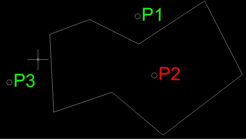

Hello!
Is there a mathematical method that can check if a point is inside an area bounded by a polyline?
Graphic method by reporting point P (x, y, z) and then use ssget function to see if it is inside, is slower.

I wanted to research this one a while ago, and there is quite a lot of information out there on this question.
Try google searches. I quickly found a thread at the swamp which may help. http://www.theswamp.org/index.php?topic=1890.0 But I think you'd even find this on Wikipedia. :lol:
The most popular method seems to be send out a few rays at random angles and count the number of intersections. If none of the rays report an even number of intersections with the polygon then it has to lie inside. If I find any more links I'll post them.

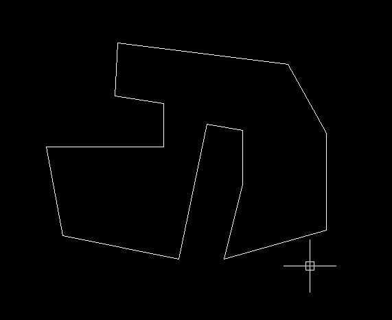

Here is a simple function implementing a ray-casting algorithm.
However, note that this function does not test whether the ray 'grazes' a vertex - for example, in the following image the function will incorrectly determine the point as being outside the polyline since the ray intersects the boundary an even number of times.
