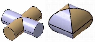

fuccaro Posted December 2, 2008 Share Posted December 2, 2008 My job is mechanical so I my be wrong. It seems to me that is the intersection of two equal cylinders that met at 90deg. Quote Link to comment Share on other sites More sharing options...

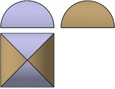

fuccaro Posted December 2, 2008 Share Posted December 2, 2008 see here what I meant: Draw two cylinders and intersect them. Cut the result in half keeping only the upper part Is it close enough what you need? Quote Link to comment Share on other sites More sharing options...

fuccaro Posted December 2, 2008 Share Posted December 2, 2008 Thanks for your comments. You made me a good day! Looking again at the images: maybe it should start from elliptical cylinders? Or the solid resulted from regular (circular) cylinders should be scaled down in one direction? Quote Link to comment Share on other sites More sharing options...
FrankG Posted December 2, 2008 Author Share Posted December 2, 2008 Brilliant fix. I agree, these shouldn't be perfectly round. I think it would be a 84"w x 64"h cylinders with the height cut in half to get the 32" final height! I'll let you know how it goes once it's in place on the actual model. Quote Link to comment Share on other sites More sharing options...

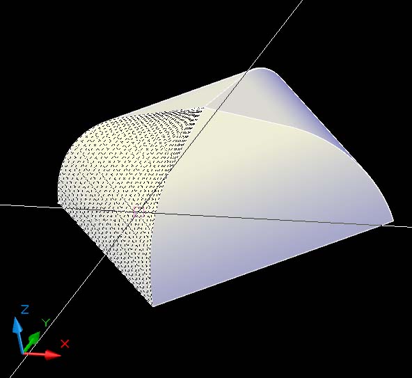

FrankG Posted December 2, 2008 Author Share Posted December 2, 2008 As you can see, the cylinder solution was perfect. Now I can keep going on the model! Note, there's not a ton of detail here because the 3D model is actually for a 1:160 plastic reproduction, so I need to include only what can be manufactured effectively. Quote Link to comment Share on other sites More sharing options...
