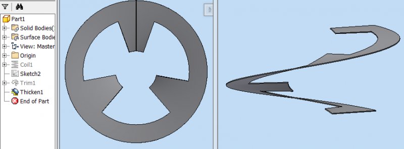

Nifty280 Posted February 28, 2014 Posted February 28, 2014 I require some advice / suggestions please as I need to draw a 3D heli-coil with cutouts. This is for a mixing auger where will be using ribbon flight with an integral leg to the centre pipe. I have no problems with the heli-coil just the cut out sections! Quote

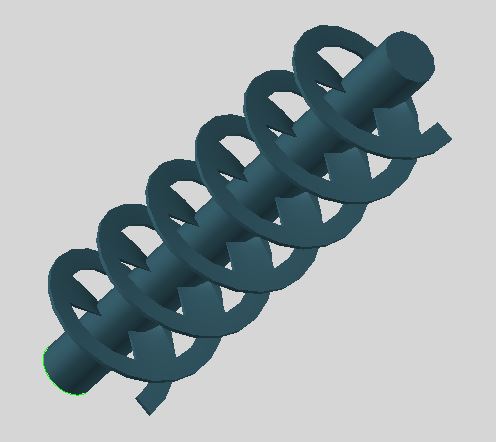

ReMark Posted February 28, 2014 Posted February 28, 2014 This is my "rough cut" as I've got some tweaking left to do but at least it is a start. Quote

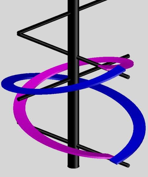

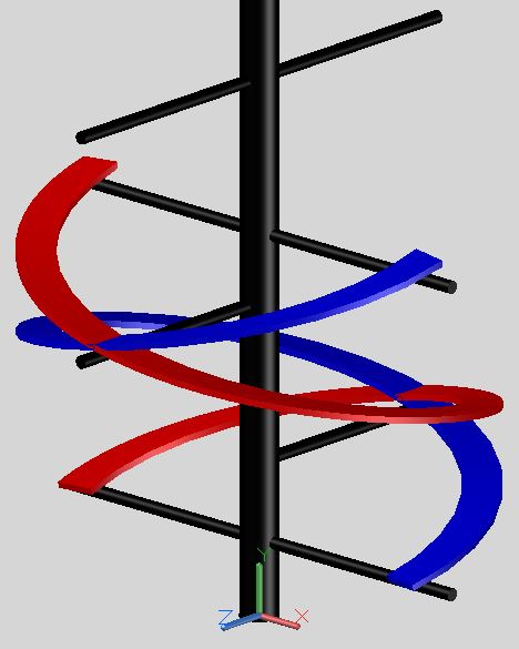

ReMark Posted February 28, 2014 Posted February 28, 2014 My variation on a theme Opus 1. The magenta helix is inside the blue helix. Oops...I think one of the support posts is out of place. My advice/suggestions would be to not do what I did. Quote

ROBP Posted February 28, 2014 Posted February 28, 2014 I would not do cut outs i would simply offset it equal distance from the middle post that way it roll equally balanced inner and outter. Just like the one remark posted. In the shop it will be easy to make for the workers and like the one on the site you posted rings are cut out all the same sizes. Voila the best and cheapest way to do it. R Quote

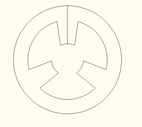

Nifty280 Posted March 1, 2014 Author Posted March 1, 2014 Shows profile of the ribbon flight before it is pressed / pulled. Quote
ReMark Posted March 1, 2014 Posted March 1, 2014 What data can you provide regarding the helix? The one you have pictured is quite different than most I have seen. Quote

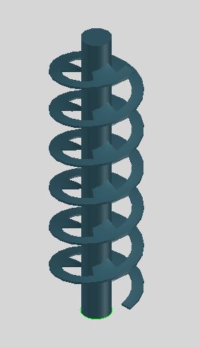

JD Mather Posted March 1, 2014 Posted March 1, 2014 ...I have no problems with the heli-coil just the cut out sections! And yet, you still haven't attached your *.dwg file here. Trim helical surface. Thicken. Done. Quote
ReMark Posted March 1, 2014 Posted March 1, 2014 (edited) Well that was easy. Next! Wait. Can you demonstrate how it would be done in AutoCAD too? Edited March 1, 2014 by ReMark Quote
JD Mather Posted March 1, 2014 Posted March 1, 2014 (edited) Well that was easy. Next! Wait. Can you demonstrate how it would be done in AutoCAD too? Attach your dwg file here. (of swept helical surface) When I think heli-coil this is what I think of http://www.helicoil.in/ used a lot of those in my previous work-life. Edited March 1, 2014 by JD Mather Quote

ReMark Posted March 1, 2014 Posted March 1, 2014 My first (rough) attempt using AutoCAD. Before anyone starts throwing bricks I've yet to work out some of the kinks. In other words...I know there is something wrong with it. Consider it a work-in-progress. Quote

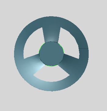

ReMark Posted March 1, 2014 Posted March 1, 2014 Top view. Looks kind of like a steering wheel. Twist it up baby! Twist it up baby. Twist and shout! OK. That's enough fun and frivolity for one morning. Time for an early lunch. Quote

Nifty280 Posted March 2, 2014 Author Posted March 2, 2014 JD that's exactly what I'm after and I was actually going to draw this in Solid Works. Could you please humour me and explain that process with a bit more detail. Quote
