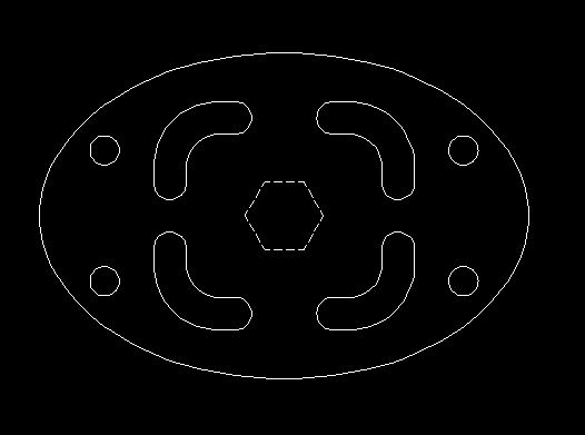

fishwater71 Posted March 21, 2014 Posted March 21, 2014 This is my first CAD class I feel freaking lost and increasingly frustrated. Need help trying to finish this slotted ellipse. It's out of a book so I cant post the pic. Here is the file of what I have already. Hopefully somebody recognizes this and can help. Thanks. slotted ellipse pg190.dwg Quote

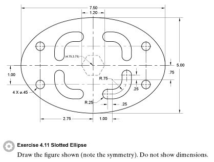

ReMark Posted March 21, 2014 Posted March 21, 2014 What is the name of the book? What is the figure number for the exercise? Or....take a good digital photo of the page of the book and post the image. Quote
fishwater71 Posted March 21, 2014 Author Posted March 21, 2014 The book is Tutorial Guide to AutoCad 2014 exercise 4.11 slotted ellipse on pg 190. Thank You. Quote
ReMark Posted March 21, 2014 Posted March 21, 2014 Oh, THAT exercise 4.11! I think this is it. Looks easy enough. Draw one side then mirror the result. Quote
fishwater71 Posted March 21, 2014 Author Posted March 21, 2014 That is the one. If you open the file I posted you can see that I am lost on how to make and place the L-shapes. Also lost on how to use mirror. Just so confused. Any help is appreciated. Thanks for your time. After this one I have exercise 4.6 interchange. Quote
ReMark Posted March 21, 2014 Posted March 21, 2014 Take a close look at the offsets for the slots that are given, namely the 1.00 and 0.75 dimensions then note the setback of 0.25 which will tell you where the center of each semi-circle is located. What is your problem with the Mirror command? Pick the geometry you want to mirror, select your basepoint (hint: intersection of your vertical and horizontal construction lines that pass through center of ellipse), then move your mouse while watching where your new mirrored geometry appears on screen. Make your final pick based on what you see. Quote
resullins Posted March 21, 2014 Posted March 21, 2014 Where I would start with the L shapes is finding the center of the main arcs. If you look, you have a radius of 0.75, with a center point that's @0.75,-0.75 off the center of your main ellipse. Place that circle, then offset it by 0.5 to create the outside of your L shape. After that, you can try to place you end caps. You'll need to take you two circles and trim them at the quadrants (unless of course you made arcs), and draw two 0.25 lines up or out from the ends. That will give you a place from which to find your center point for the end caps. Quote

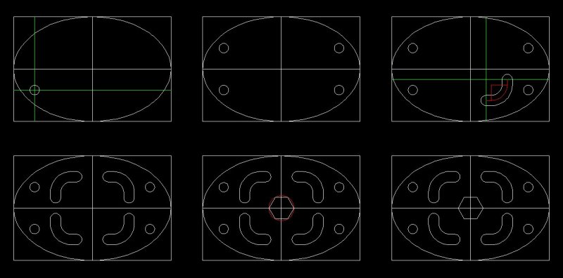

ReMark Posted March 21, 2014 Posted March 21, 2014 One possible way is depicted in the progression above. Commands used were Rectangle, Ellipse, Line Offset, Circle, Mirror, Trim and Polygon. The Polygon has to be Inscribed within the circle shown in red not Circumscribed about it. Quote

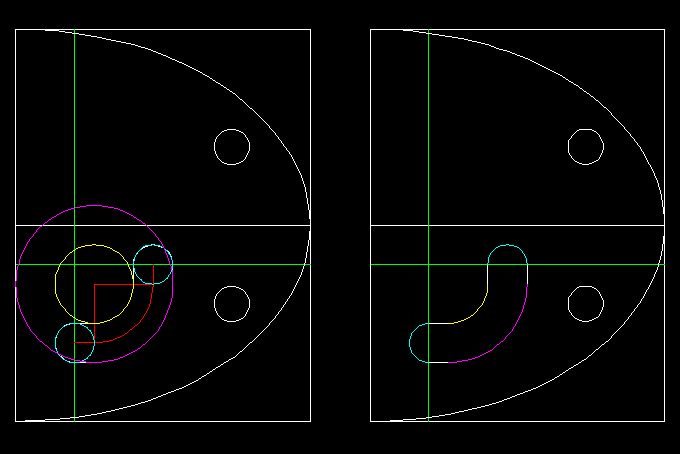

ReMark Posted March 21, 2014 Posted March 21, 2014 A close up of the lower right hand quadrant of the ellipse showing the creation of one of the slots. I used a different color for each circle just for affect. Quote

ReMark Posted March 21, 2014 Posted March 21, 2014 To make sure the centerlines were correct in relation to the ellipse I thought you might find it easier to draw a rectangle first and then place the ellipse inside it. I did not expect you to do the opposite. Orthomode keeps lines straight whether drawn vertically or horizontally. Re: linetype. Did you load one of the Center linetypes yet? If so I would create a separate layer called Centerlines, assign it a color other than white, and assign one of the center linetypes to the layer. Do you know how to do this? Quote
