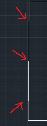

hht Posted March 27, 2014 Share Posted March 27, 2014 I am trying to draw a rectangular but sth is wrong. can you explain me please what causes these mistakes? Quote Link to comment Share on other sites More sharing options...
MSasu Posted March 27, 2014 Share Posted March 27, 2014 What command did you used? Is clear that is a sloped line, but why is like that depends on your draw approach. If you used the RECTANGLE command, then most probably your UCS is slightly rotated. Call UCS with World option to fix it. If this is the result of a LINE or PLINE call, then check the points or lengths you inputted. Do you had Ortho mode activated? It may help to post here that sketch. Quote Link to comment Share on other sites More sharing options...
hht Posted March 27, 2014 Author Share Posted March 27, 2014 What command did you used? Is clear that is a sloped line, but why is like that depends on your draw approach. If you used the RECTANGLE command, then most probably your UCS is slightly rotated. Call UCS with World option to fix it. If this is the result of a LINE or PLINE call, then check the points or lengths you inputted. Do you had Ortho mode activated? It may help to post here that sketch. I was just trying to draw a rectangular by line command but ortho wasn't activated. Quote Link to comment Share on other sites More sharing options...
MSasu Posted March 27, 2014 Share Posted March 27, 2014 If you inputted length of edges by direct distance entry method without Ortho activated, then may be possible that all edges were sloped. Please check these tutorials on AutoCAD input: http://www.cadtutor.net/tutorials/autocad/direct-distance-entry.php http://www.cadtutor.net/tutorials/autocad/using-coordinates.php Please don't quote the previous message, since this will just make the thread difficult to follow. Quote Link to comment Share on other sites More sharing options...
ReMark Posted March 27, 2014 Share Posted March 27, 2014 Do not draw what you think of as straight lines unless you either have orthomode enabled or are using polar tracking otherwise you end up with a case of the "jaggies". Quote Link to comment Share on other sites More sharing options...
hht Posted March 27, 2014 Author Share Posted March 27, 2014 But polar tracking and probably object snap was activated only ortho was not activated. I think edge points of rectagular was not aligned. Quote Link to comment Share on other sites More sharing options...
ReMark Posted March 27, 2014 Share Posted March 27, 2014 Then maybe it was the ten cups of coffee you had that gave YOU the jitters. Enable orthomode and erase all doubt. Quote Link to comment Share on other sites More sharing options...
