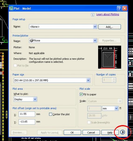

pancake Posted April 1, 2014 Share Posted April 1, 2014 I am new in Autocad, Someone sent me the file acad ctb for line thickness, do you know how can I use it? Thanks Quote Link to comment Share on other sites More sharing options...
Tiger Posted April 1, 2014 Share Posted April 1, 2014 I would start with renameing the file to perhaps MyOwn.ctb or something - you will probably find an existing ACAD.ctb. Right-click on the commandline > Options > Files > Printer Support File Path > Plot Style Table Search Path - - in this location is where you place your acad.ctb After that, reboot AutoCAD (I think, could work anyway), start the Plot command, at the top right corner is a PLot Style-box, find your ACAD.ctb and use it. If everything is done correctly, your drawing should plot correctly. Quote Link to comment Share on other sites More sharing options...

pancake Posted April 1, 2014 Author Share Posted April 1, 2014 Sorry Tiger thanks for the reply, but I didn't understand the second part of your message, where I should find my acad? Plot style box? Quote Link to comment Share on other sites More sharing options...
dbroada Posted April 1, 2014 Share Posted April 1, 2014 If you don't have a plot style box you may have to open up your box. Press the arrow in the bottom right corner to expose the full screen. Quote Link to comment Share on other sites More sharing options...
tzframpton Posted April 1, 2014 Share Posted April 1, 2014 Sorry Tiger thanks for the reply, but I didn't understand the second part of your message, where I should find my acad? Plot style box?"acad.ctb" is the default plot style that is installed with AutoCAD. Assuming the one that was sent was not tampered with (eg: altered in any way from the original), and if your plot style location is also the installation default (meaning you, or your I.T. department, never changed this search path) then you should already be set up. Acad.ctb is an Object based color table, so whatever the lineweight is set on the Layer or Objects is what it'll print at. Quote Link to comment Share on other sites More sharing options...
pancake Posted April 1, 2014 Author Share Posted April 1, 2014 thank you dbroada, I got it ;-) Quote Link to comment Share on other sites More sharing options...
