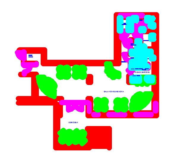

Aardenon Posted April 3, 2014 Share Posted April 3, 2014 Hi, I'm very new to AutoCAD. I have to make a floor plan. It's going well, except for the line thickness. When I'm zoomed in in model space, I set the thickness to say 1 mm, but when I zoom out the lines get unusually thick - it's still the same 1 mm on screen, but now the drawing is unproportionally small. I would like the line thickness to scale with the drawing, with the zoom. I hope I make myself clear. I'm using AutoCAD 2013 for Mac. Can anyone help? Thanks. Quote Link to comment Share on other sites More sharing options...

Aardenon Posted April 6, 2014 Author Share Posted April 6, 2014 Hello Guys, First of all thank you very much for all help. Please excuse my newbieness in the AutoCAD territory. I'm a graphic designer used to Illustrator more than to CAD software. I'd been asked to do this drawing only because I can also visualize it later in 3D in Cinema 4D. I understand now that I should stick to thin hairlines in Model Space. So I set all lineweights back to defaults (I assigned Default to line weights in all layers). But now I need to export the drawing to PDF and also print a copy. So in Layout view I assigned line weights to each layer (in the Layer panel), such as 0.15 mm or 0.25 mm. But after export or print I get lines that are 2-3 cm wide. It results in horrible thick blobs of color, obscuring the drawing completely. I lack basic What You See Is What You Get functionality. What I get after export doesn't match what I see on screen. Can anyone help? How to control line weights properly for export and print? Thanks a lot! Quote Link to comment Share on other sites More sharing options...

Aardenon Posted April 6, 2014 Author Share Posted April 6, 2014 Here you go. plan-05b.dwg Quote Link to comment Share on other sites More sharing options...
eldon Posted April 6, 2014 Share Posted April 6, 2014 The plot does seem to have rather thick lines. I think that your problem starts with you using an imperial template for starting the drawing, which then appears to be in metre units. Try starting with a metric template in the first instance Quote Link to comment Share on other sites More sharing options...
Dana W Posted April 6, 2014 Share Posted April 6, 2014 (edited) The plot does seem to have rather thick lines. I think that your problem starts with you using an imperial template for starting the drawing, which then appears to be in metre units. Try starting with a metric template in the first instance Meters? That would account for checking off the "Scale Lineweights" box making the lines 100 times too thick. Edited April 6, 2014 by Dana W Quote Link to comment Share on other sites More sharing options...

Aardenon Posted April 9, 2014 Author Share Posted April 9, 2014 Hi. I fixed the lineweights. It seems I indeed had the Scale Lineweights checkbox turned on. I ticked it off and I got normal correct lines. But I have one more problem. With the scale. I set the units of the document to meters (ddunits). So for example one of the windows is 2.4 units wide. That seems good: 2.4 units – 2.4 meters. But when I switch to Layout view. I set the scale of the drawing to fit A3 paper size for print - and the scale that fits is 1:3 which is nonsense. It makes the whole room be less than a meter long! What am I doing wrong? Thanks. Quote Link to comment Share on other sites More sharing options...

eldon Posted April 9, 2014 Share Posted April 9, 2014 But I have one more problem. With the scale. I set the units of the document to meters (ddunits). AutoCAD either plots in inches or millimetres. To check what units you are using, it is simple to go to your Layout, and measure the sides of the drawing. If you get (approximately) 15 x 10, then your plotting units are inches for an A3 sheet. If you get (approximately) 390 x 260, then your plotting units are millimetres for an A3 sheet. Until you get the size correct, you will be struggling with the logic of scales AutoCAD does not plot in metres, and a more realistic scale would be 1 to 100. Quote Link to comment Share on other sites More sharing options...
