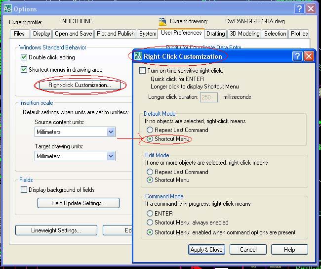

Where u have objects selected, then you right-click drag and let go and a pop up menu shows up for move,copy, and other options.
Maybe your right click is not customized like that.
go to options then....
