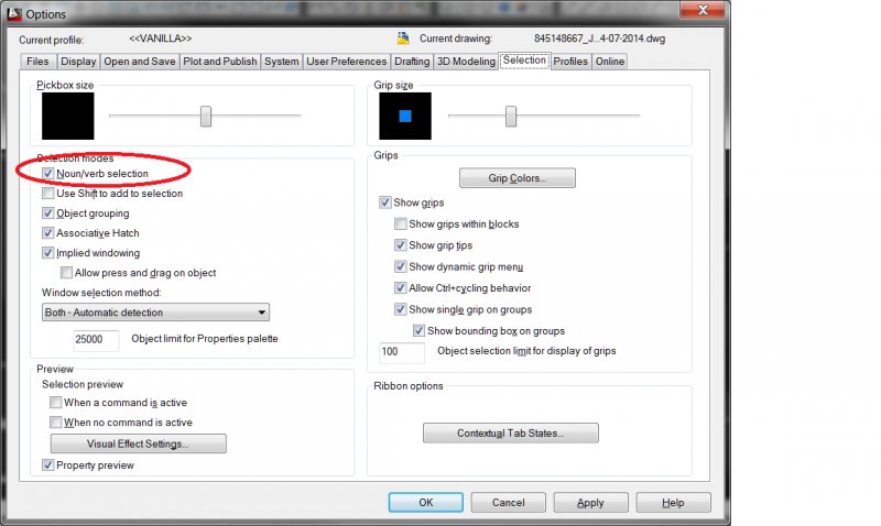

check this setting
That does the same thing I mentioned. Pickfirst is the variable that controls the Noun/verb selection. Changing the Pickfirst setting to 1 or 0 toggles the Noun/verb selection on and off.
