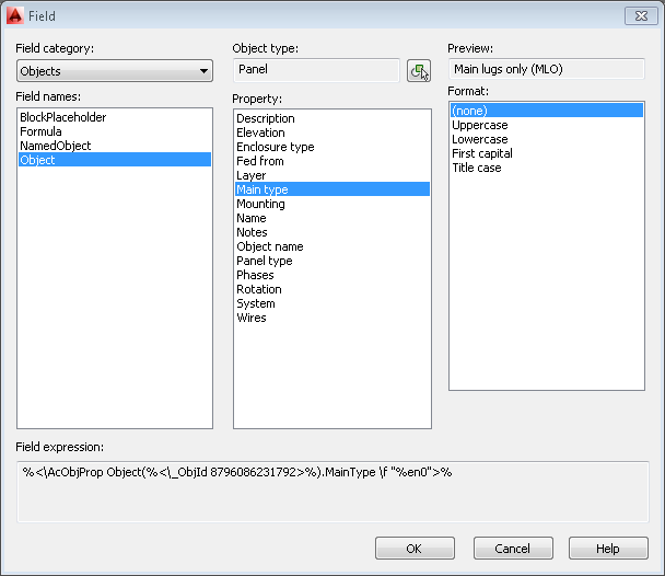

Im trying to get my Panel Schedules to report the "main type" as MLO or MCB. I went into the panel drawing and inserted the field (?pnlmntype) i refreshed and updated my panels and it still wont show up in my panel schedules. Thots?

I just tried for an hour to make the changes you are looking for, but was unable to. I copied the style drawing for panel schedules and then copied one of the tables in the drawing. When I add a new row and cell for main type, Amep crashed three out of three times. I must be doing something it doesn't like, because Amep rarely crashes for me. When I edit one of the existing fields to show main type it always goes back to the stock template when refreshed. It also does that in a test drawing. maybe the only thing left is to start completely from scratch?

Instead of using the "AEC Panel" Field Category, I got it to work by using the "Objects" Field Category. When you select this option, then select the subsequent Option under Field Names, there's a Select button next to Object Type. Use this to select the Panel, then it gives you "Main Type" as a Field Property which populates the information.
Hope this helps. :)

I tried using the OBJECT and it worked but is it just for that drawing? In my panel schedule table styles (imperial) dwg i dont have any panels to select.
As far as I can tell, yes - only for that drawing. I have no idea why the AEC objects aren't calculating. Maybe the stock panel MvPart wasn't created correctly... this would be my first guess as to why it's not populating. Have you tried making a panel from scratch?
Might even warrant a ticket to Autodesk themselves to see if they can't uncover the problem.
