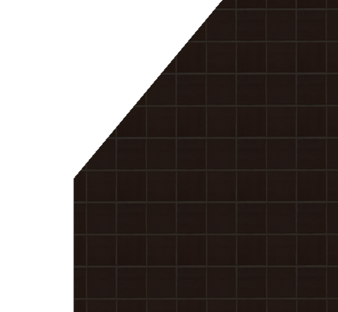

nicolas Posted May 5, 2014 Share Posted May 5, 2014 Hi, I am having quite number of problems with applying materials on a project. Each time I apply a 600x600 Floor or Wall Tiles materials, it happens that the tiles are placed at an angle (diagonally) instead of being ortho. I know I can use Planar Mapping with Rotate but there is no option to set an angle. It seemed that modification is applied visually. Is there a way for the material to be applied as per current UCS? One of the edges is diagonal and I believe this is the reason for the materials to be applied diagonally. Thanks in advance for your help. Quote Link to comment Share on other sites More sharing options...
ReMark Posted May 5, 2014 Share Posted May 5, 2014 (edited) Have you tried the MATERIALMAP command? First you have to select an option like Box, Panar, etc. then you can move or rotate the material using the appropriate "gizmo". End result: Edited May 5, 2014 by ReMark Quote Link to comment Share on other sites More sharing options...
nicolas Posted May 5, 2014 Author Share Posted May 5, 2014 I used the said command, select PLANAR, do the rotation. The problem is that I don't know if its precise as it does not work like actual 2d or 3d rotate rather it is done visually. I mean there is no way to know if the tiles are set in ORTHO position. I, also try the copy mapping but nothing changed. The only solution was to do a rectangular box, apply the materials then substract part of it so that the shape match. It seems strange that due to 1 of the edge being diagonal, the whole materials follow that orientation. Quote Link to comment Share on other sites More sharing options...
ReMark Posted May 5, 2014 Share Posted May 5, 2014 As you can see from the image I posted I had no trouble turning the tiles 45 degrees. Everything appears to line up. Quote Link to comment Share on other sites More sharing options...
