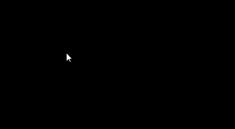

To go with Dynamic graphic you will loose the snap objects , so here it goes below :)
[ATTACH=CONFIG]48721[/ATTACH]

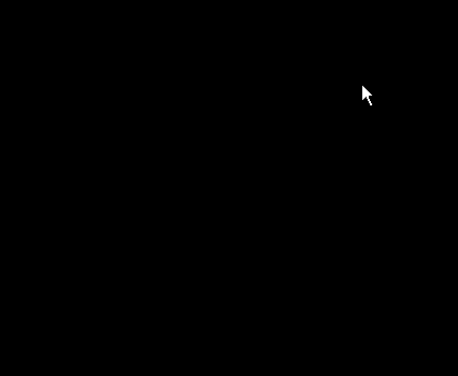

Thank you marko, There are three problems.
1. Only use ortho mode.
2. Will be automatically cancelled “Autosnap settings”.
[ATTACH=CONFIG]48733[/ATTACH]
3. Can't input Line length.
1. You can switch orthomode on or off with F8 key, with F10 you can switch polar tracking on or off, with F3 you can switch osnaps on or off...
2. I don't understand this - Just check that (logand (getvar 'autosnap) 8)=8 and (logand (getvar 'autosnap) 16)=16... If that's the case, then you comment out line (setvar 'autosnap 31)
3. Yes, you can't enter length as this codes uses (grread) to obtain end points...
M.R.
