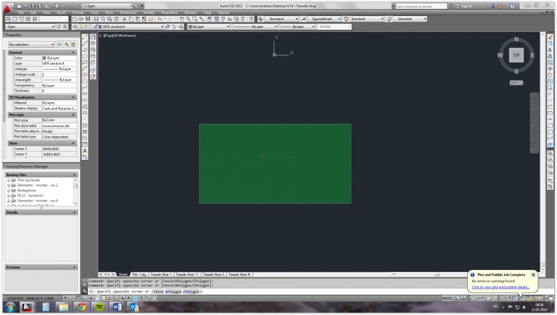

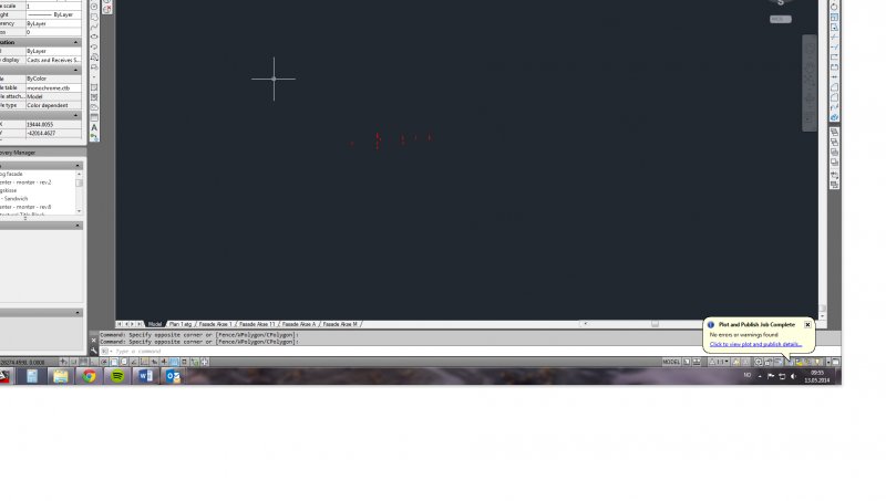

But somehow, in this drawing there are some red lines that i cant delete? I cant even get a hold of them and move them. This is something that followed a drawing from an architecht. It does not show up in prints, but i want it gone anyway ;)
Adding a couple of screenshots to show you.
Its a little hard to see, but if i zoom in further, it disappears!
I have now tried to delete and purge almost everything, but its still there! Does anybody know what this is?

Hi, thanks for the suggestions.
But no, i dont get any messages, because i cant even mark them..?
Its like its not drawn, but its there anyway, heh...:?
I also see this in the layouts, but not on my prints.
Ive tried deleted all my layers, but it still wont go away. Tried REGEN and AUDIT now but that does not work either.

my system shows then as being text but as you say, I can't select them manually. They do however purge here or can be removed by QSELECTing all the TEXT in the drawing and deleting them. I suspect something left over from a deleted block.
further test seem to confirm that they are just left over from something in the past. They disappear if I purge ANYTHING.
Heh! Nice work! QSELECT was a new command to me, but it worked, thanks! No more irritation, for now ;)
Strange , but as Dave did, I got rid of them with the -purge command.
I was unable to identify them, other than a couple were points, and all were on the other objects layer.
