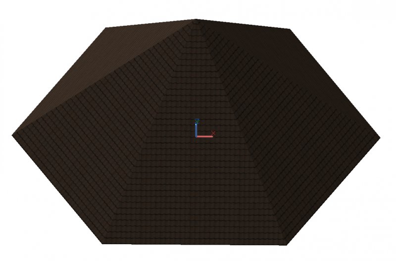

Zox Posted May 13, 2014 Posted May 13, 2014 I'm drawing a roof and I put tiles texture on it but it appeared on wrong sides: as you can see tiles are shown on the "slimmer" side while I would need it on a wider side and I can't figure out how to edit it. Quote

Randolph Posted May 14, 2014 Posted May 14, 2014 I don't know how to rotate texture. Open Materials Browser. Double-click on your material. The Materials Editor opens. Double-click on the image preview. The Texture Editor opens. Under Transforms > Position you will find Rotation. Somehow like scratching with the right hand on the left ear, isn't it. But I'm afraid that rotationg the image won't help. Quote

Randolph Posted May 15, 2014 Posted May 15, 2014 Yes, why is the roof standing upright? Simplest thing in this case is to assign a neutral material, then explode your solids, and assign the roofing to the top regions. You will need 2 versions of the roofing material with 180° rotated textures. Your problem with the texture positoning I can't reproduce, as I'm using ACAD 2012. Quote
Zox Posted May 22, 2014 Author Posted May 22, 2014 Yeah it's a real bummer I don't know how to rotate textures. I now have this kind of roof and don't know how to rotate them to look downwards. Quote
ReMark Posted May 22, 2014 Posted May 22, 2014 Is this representative of what you are trying to do? Material: Spanish Tiles Quote
ReMark Posted May 23, 2014 Posted May 23, 2014 (edited) I've mentioned this twice now. It was done via the Material Mapping option. You may have to experiment using the option Planar and/or Box. BTW....what I pictured was the first time I ever worked with roof tiles and maybe only the third time I have used materials in a 3D model. This is not a normal part of my job. Edited May 23, 2014 by ReMark Quote
Zox Posted May 27, 2014 Author Posted May 27, 2014 I'm still battling it around. I do click 'Material mapping' and I get these arrows and polygon and I move/rotate them around and it seems there will be something. Thanks! Quote
