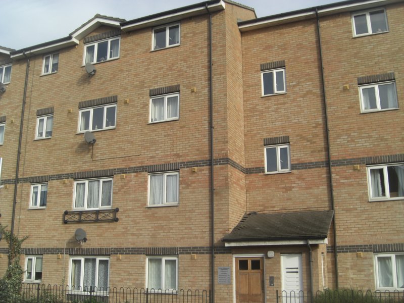

pancake Posted May 16, 2014 Posted May 16, 2014 Can you help me to draw the window pitched roof in the picture? Thanks Quote

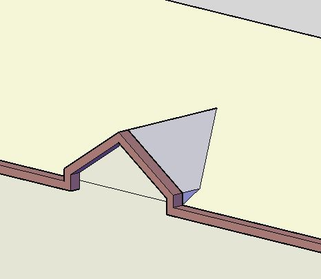

ReMark Posted May 16, 2014 Posted May 16, 2014 Something like this quick mockup? Since there were no dimensions or roof pitches mentioned I just guessed. Quote

ReMark Posted May 16, 2014 Posted May 16, 2014 I used a couple of profiles. One of them I extruded outward and the other I extruded inward. The two different roof lines were unioned together. Quote
pancake Posted May 16, 2014 Author Posted May 16, 2014 I used a couple of profiles. One of them I extruded outward and the other I extruded inward. The two different roof lines were unioned together. sorry I need more details, can you post the 2 profiles you used? Quote
ReMark Posted May 16, 2014 Posted May 16, 2014 They would not do you any good. One of them should be very obvious (the brownish colored one). The other was a triangular profile for the small roof that is above the window. I just had an opportunity to open your drawing. It looks like you already have some of what you need in the 3D solid to the left (greenish color building). Can you provide any dimensions for what remains to be done? BTW...There are more than a few parts of your building that may need further review. I think you should stop right now and redraw your building. Sorry. Quote

ReMark Posted May 16, 2014 Posted May 16, 2014 You need to fix your roof for starters. Look closely at one of the large roofs and notice you have a double rigdeline. Look closely at the small connector roof and notice that the slopes don't match up to the main roof and that it appears to slice into one of the adjacent roofs. Note too that you have no headers above your window openings on the top floor and it appears that all your windows may be too high up the face of the building. Did you give yourself any reference points for the elevations of each floor so you could be certain that a person standing inside could actually see out the windows on a given floor? Quote
pancake Posted May 16, 2014 Author Posted May 16, 2014 yes I know, I will try to redraw the roof. Can you explain step by step, how you will make all the roof as in the picture? Quote
ReMark Posted May 16, 2014 Posted May 16, 2014 You did not provide a picture of the entire building so I don't know for sure what the roof does at each end. My guess is that it is a gable end roof and does not slope like you have it in your drawing. The good news if that were true would be that creating the roof in 3D would be easier. Create the profile (a triangle) and extrude it. How did you determine the height and pitch of the roof? Quote

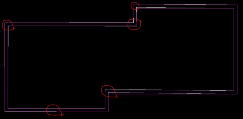

ReMark Posted May 16, 2014 Posted May 16, 2014 Well that is moot at this point. Your building footprint is skewed meaning lines are not at right angles to each other. You will have to start all over and reconstruct the building correctly. Quote
ReMark Posted May 16, 2014 Posted May 16, 2014 Here's is the basic problem with your building. Your building footprint is in white; mine is in magenta. Notice anything odd? So, you extrude a misaligned footprint upwards and everything you do after that is negatively affected. That includes any openings for doors and windows plus anything you do with your roof. If the foundation of your building is bad then the building itself will be bad. No two ways about it. Square things off in your building footprint and you'll be off to a better start. I have to go now as I haven't eaten all day. I'll try to check back later. Do not get discouraged. Everyone, including myself, makes mistakes. And find a good book about architectural design if that is what you are interested in. Stick to good design principles and you won't go wrong. Quote
