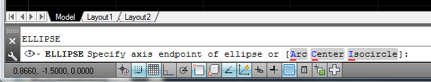

Chris23 - make sure you are looking at the command line and not the text screen.
[ATTACH=CONFIG]49043[/ATTACH]
Momma said there would be days like this.
Yep that is exactly what I am looking for but mine is not clickable anymore or blue. I was thinking maybe I hit one of the function keys and turned it off but I tried that also.
