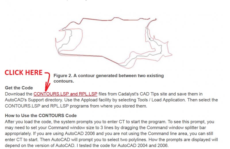

neophoible Posted May 22, 2014 Posted May 22, 2014 I couldn't find the download anywhere, or even the "get the code" section where they said the download would be. ;/ Odd...Try the following steps, noting that I am zoomed in on the pages a bit and that I'm actually showing portions of 2 pages here: Quote
WindowsIHateYou Posted May 23, 2014 Author Posted May 23, 2014 LOL, thanks. Mouseover did nothing on that button so I thought it wasn't a button, and was just a poor label for the "Print" icon next to it. Quote

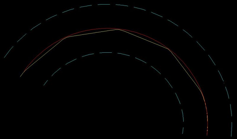

WindowsIHateYou Posted May 29, 2014 Author Posted May 29, 2014 Well I couldn't figure out the variables on "rollin" to get it smooth through a curve. I did manage to figure out the "contours" variables. blue= orig red= contours yellow= rollin Quote

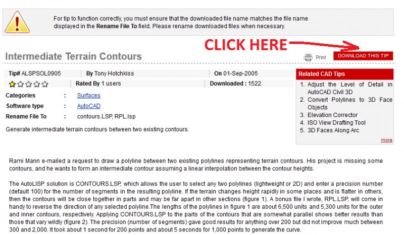

WindowsIHateYou Posted August 28, 2014 Author Posted August 28, 2014 (edited) This lisp routine will work.http://www.cadalyst.com/general-software/autolisp-solutions-create-long-intermediate-terrain-contours-3103 I'm on a new computer, so I went to download the lisp again, and the Cadalyst site hates me and gives me a "403 Forbidden" when I try to download the tip. I found it elsewhere, but I'm wondering if anybody else is getting the 403. Edited August 28, 2014 by WindowsIHateYou Quote
WindowsIHateYou Posted August 29, 2014 Author Posted August 29, 2014 still doesn't work for me. the "download tip" link on this page: http://cadtips.cadalyst.com/surfaces/intermediate-terrain-contours Quote
Dana W Posted August 29, 2014 Posted August 29, 2014 still doesn't work for me. the "download tip" link on this page: http://cadtips.cadalyst.com/surfaces/intermediate-terrain-contours Do you have to be a "member" to download? I didn't sign up, and it doesn't work for me either. Quote
WindowsIHateYou Posted August 30, 2014 Author Posted August 30, 2014 Do you have to be a "member" to download? I didn't sign up, and it doesn't work for me either. I wasn't before, but I became a member to try. It still didn't work. so I've tried 2 desktops and a mobile, and I still get the same error. Quote
Dana W Posted August 30, 2014 Posted August 30, 2014 I wasn't before, but I became a member to try. It still didn't work. so I've tried 2 desktops and a mobile, and I still get the same error.OK, here's another wild guess. Try a different browser. I'm using Chrome. Quote

SLW210 Posted September 2, 2014 Posted September 2, 2014 Works fine for me this morning as well. No sign in needed. I'll just post them here since they are free to distribute. contours LSP-RPL lsp.zip Quote
