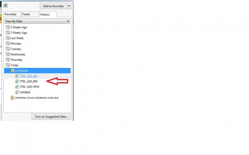

MOORADAN Posted May 22, 2014 Posted May 22, 2014 Guys, In my workstation recently installed AutoCAD 2015 and its uploading whatever the drawings I work to cloud. I need to stop it and can anyone give me a solution. cheers:( Quote

MOORADAN Posted May 23, 2014 Author Posted May 23, 2014 Guys, I uninstalled AutoCAD360 and signed out of the Autodesk Online... Still it does all those uploading... Dadgad, Can you explain your way in bit more detail please.... Quote

MOORADAN Posted May 23, 2014 Author Posted May 23, 2014 No... No... No... I installed program from your link and installed... Gave me the notification saying its switched off all the background activities... But still showing the upload in the history of my internet explorer... Any further hint Quote
Dadgad Posted May 23, 2014 Posted May 23, 2014 Sorry, if I was mistaken. Have you rebooted your system? You didn't answer my questions about how you deleted Autodesk 360? I am having a hard time understanding how software which is no longer on your system is still running on, and accessing your files? When you look in your Programs folder, is it still shown there? Quote
MOORADAN Posted May 23, 2014 Author Posted May 23, 2014 For uninstalling the AutoCAD360, I have gone to programs and right clicked and uninstalled... I checked again now, there is nothing named AutoCAD360 in the program list... Quote

MOORADAN Posted May 28, 2014 Author Posted May 28, 2014 Thanks guys.. Especially Dadgad... Uploading stopped when I uninstalled AutoCAD360... But unfortunately the image was showing the drawings I worked on each day... Confused with uploading... It was a cheeky mistake... Quote
