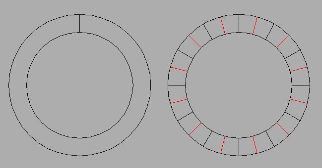

wanted90 Posted May 30, 2014 Posted May 30, 2014 Hi Could please help me , I need drwa those two red line How I can drwa that which angle I will use ? http://www8.0zz0.com/2014/05/30/11/413126292.jpg Quote
ReMark Posted May 30, 2014 Posted May 30, 2014 Think about it. You have twelve lines that go around in a circle. What command does that bring to mind? It starts with an "A". Quote

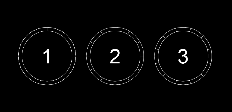

wanted90 Posted May 30, 2014 Author Posted May 30, 2014 Step 1 and 2 ok but in number I don't know what you did Quote
ReMark Posted May 30, 2014 Posted May 30, 2014 Hint: I used a Modify command that starts with the letter "R". Quote
wanted90 Posted May 30, 2014 Author Posted May 30, 2014 Hi mark still I don't know how you did that See this picture here writen polyline start width 4 end 0.1 is that mean rotation of line or what http://w5ww12.0zzbb0.com/2014/05/30/13/870926659.jpg Can please help me Quote
ReMark Posted May 30, 2014 Posted May 30, 2014 The second link does not work; not that it matters. The "R" command I hinted at is ROTATE. I'm sure you can figure out the degrees you have to rotate the lines for them to be evenly spaced on either side of the numbers on the clock/watch face. Quote
wanted90 Posted May 30, 2014 Author Posted May 30, 2014 Ok I can rotate that lines but by which dgree ? Quote
ReMark Posted May 30, 2014 Posted May 30, 2014 Ok I can rotate that lines but by which dgree ? Come on, I know you can figure this out on your own. It isn't rocket science. Look closely? Any angle immediately come to mind? Quote
ReMark Posted May 30, 2014 Posted May 30, 2014 Show some confidence in your answer by telling me. You won't know if you are right until you try. Go ahead and do it; I'll wait. Quote
eldon Posted May 30, 2014 Posted May 30, 2014 Or, you could try the polar array with 24 items, and erase every other one. You don't have to know angles for that way Quote
eldon Posted May 31, 2014 Posted May 31, 2014 The magic number 360. Or even 400, or even 3.14159....... If the OP doesn't specify, then everyone can have a guess Quote
