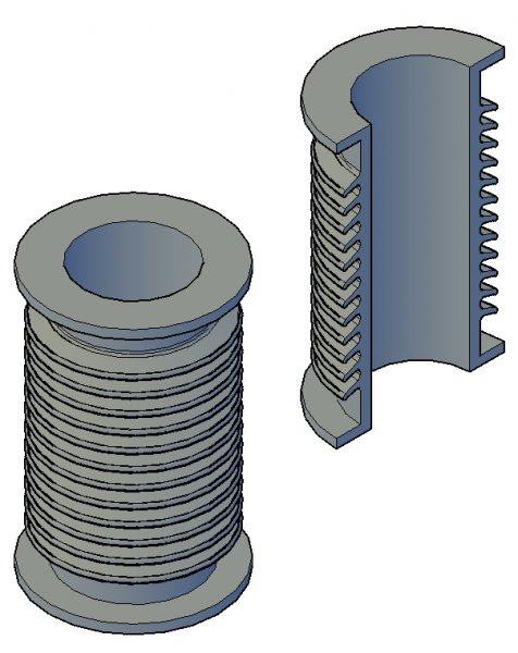

All kidding aside, the attached should be illustrative.
Illustrative....to a point. Would have been nicer if you had taken your own advice to the OP and used that for the demo. Oh well, never mind. Have fun guys.

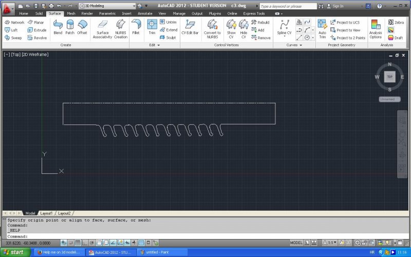

Hi,
I am beginner on 3d modeling. I know drawing on 2d only, and I have to learn to much.
Thanks for your advice, it will help me.
This is what I was made, this drawing is not good, I must work on this to much.
By,

Hi,
This is what I was made, this drawing is not good,....
Attach your *.dwg file here.

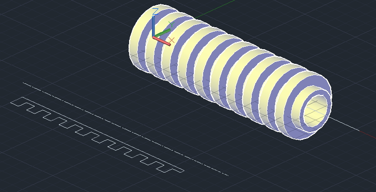

Is this the affect you were trying to achieve?
It happens to be a 3D solid model as demonstrated by the section to the right.
Yes, it was created using the REVOLVE command.
Visual style = Conceptual.
Note: If you do not used a closed polyline profile then the result will be a surface not a solid which is what I think you ended up with.

What you failed to point out in your abbreviated response (with attached image) was the fact that in order to produce a solid and not a surface the OP needed to use a closed profile. As you see by the image that I provided, and accompanying explanation, I not only created a solid but proved it via the cut-away. Your response did not include all the pertinent facts and that is one reason the OP could not obtain the result he was looking for. BTW...I am not suggesting that you leave the forum. Understood?
