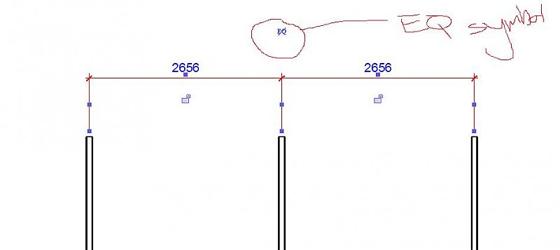

JRevit Posted December 7, 2008 Share Posted December 7, 2008 when you place the 2 dimensions you should see an EQ with a line through it, click that and it will change them to EQ note, you need to draw 2 dimensions for the little symbol to come up. also the EQ it will be above the dims, in blue. Quote Link to comment Share on other sites More sharing options...
profcad Posted December 7, 2008 Author Share Posted December 7, 2008 I'm using Revit Architecture 2009. If you look at the example above, the EQ symbols don't show up. I have been using Revit for the past several weeks now and I have never seen the symbol. When I select the dimension and right click the option to display EQ symbol is grayed out. Quote Link to comment Share on other sites More sharing options...
JRevit Posted December 7, 2008 Share Posted December 7, 2008 i will add a screenshot of the symbol, as i'm unsure why it isnt showing. what template file are you using? Quote Link to comment Share on other sites More sharing options...

nihar Posted December 9, 2008 Share Posted December 9, 2008 After dimensioning, click on the "EQ". Now both the dimensions will changed to "EQ" text. Quote Link to comment Share on other sites More sharing options...
profcad Posted December 9, 2008 Author Share Posted December 9, 2008 After dimensioning, click on the "EQ". Now both the dimensions will changed to "EQ" text. The only prolbem is I don't see "EQ". The icon doesn't appear on my screen. Quote Link to comment Share on other sites More sharing options...
nihar Posted December 10, 2008 Share Posted December 10, 2008 "EQ" is a system by default. In my Revit 2009 version it is automatically appears when i dimension two dimensions in a single stroke. just click on the "EQ" and it the displayed dimensions will automatically changes into "EQ" system. I do not know any sytem settings for "EQ". Quote Link to comment Share on other sites More sharing options...
profcad Posted December 21, 2008 Author Share Posted December 21, 2008 I figured it out. USER ERROR. I have to pick the one side first, then the other side, then the dimension in the center. Revit will create chain of dimensions. The EQ symbols will display. I was creating two seperate dimensions. Quote Link to comment Share on other sites More sharing options...

joanmilo Posted November 8, 2010 Share Posted November 8, 2010 excuse me my english, I had the same problem but when you catch it, is piece of cake, then you need put the annotate in "aligned dimension" option when you put both dimensions, these must be aligned off course the program is associating the distance betwen ones, now select the dimension and click in the "EQ" crossed brand. GOD bless you! Quote Link to comment Share on other sites More sharing options...
Zandala Posted December 27, 2010 Share Posted December 27, 2010 I'm in the process of learning Revit, in fact I'm quite new to Autodesk products in general. And I recently had the same frustrating problem as you. But I just worked out what I was doing wrong. It had to do with how I was placing the dimensions (one at a time, instead of in a string). For eg: If you have ponts A B C D E F, instead of placing the dimensions between AB then clicking BC then CD, DE, EF. You should rather click from A to B to C to D to E to F. Then the EQ symbol should display. I hope this helps! Quote Link to comment Share on other sites More sharing options...
