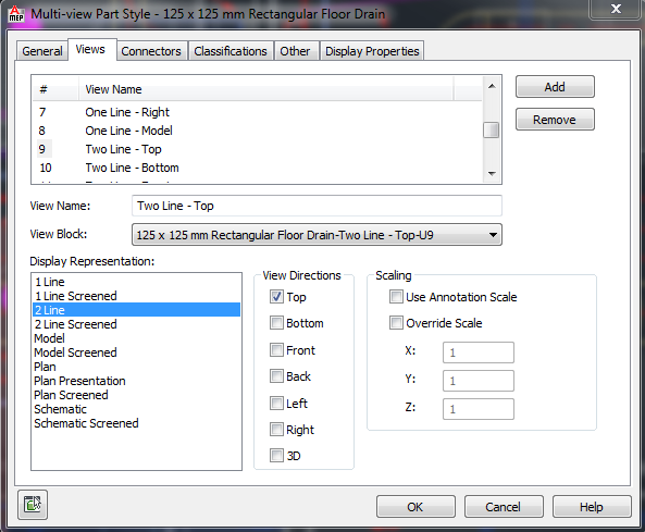

I'm trying to edit a view-block for a multi-view part. But when looking at the different views in the multi-view part style dialog the view-blocks are all named U345 or some other number. This name can't be found in the list of blocks in the drawing, and so I'm not able to edit it. I've googled that blocks with this sort of name are called "anonymous blocks", but I still have no idea what to do about it to enable me to edit them....any ideas?

Are you not able to select the block, then right click > "Edit Block In-Place" ?

hertz hound
I just tried What you are looking to do. I tried it with stock content and custom content. I was able to edit the view blocks that I tried, so I am not sure why it is not working for you?
In the edit style dialog box, I looked for the different view blocks that were used by the part. They all started with the part name and ended with Uxxx view block name. I left that dialog box and typed BE to open the block editor. I chose the view block I wanted to edit from the list, and had no problem editing it.
For the two MVparts I tried, I could not find the name of the top view block for plan view. I used the name of the view block for two line. I block edit that block by drawing an x across it, and saved it. It was not evident that I changed anything until I selected it and in the display tab of the properties pallet, changed it back and forth to "By object". It took to the update. it would not do that with a regen. Sometimes that happens with regular blocks where you have to switch it out with another block and back to notice a change. I have noticed that with Tags that use MVBlocks.
I tried it with other top view blocks and the X only showed up when I did it to the two line block as above. The X also showed up without manipulation of the properties pallet when I changed the display rep to MEP two line.
So the only thing I see as being weird is that the MVPart has no block listed as being the top view block for plan View in the edit style Dialog box, and I had to try several before it made a change.

These are screens of two different parts where one is OK, and the other is as I described.
I have no idea why one behaves differently from the other...
You see the part name at the top - they are both out of the box parts.
