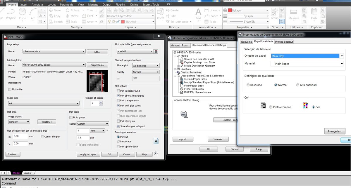

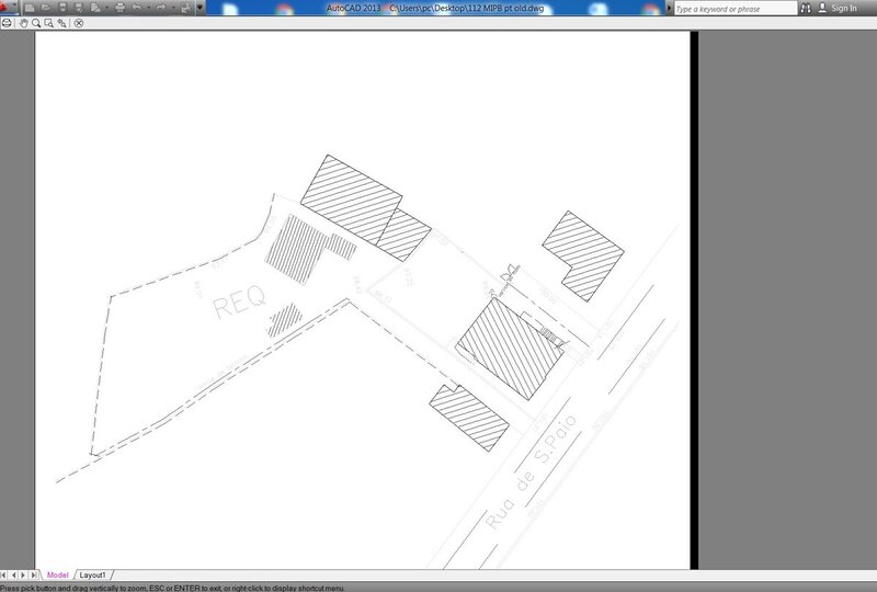

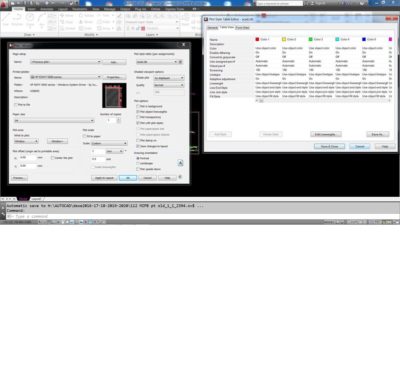

jjtalmeida@gmail.com Posted November 2, 2020 Share Posted November 2, 2020 Hi people, I needed your help ,, I'm using the HP Envy5000 home printer on PC / win7 and I print well in color. (office) With the configuration in HP Envy 5000 series of the "windows system driver" in the plot in Autocad, in Model space plot configuration - even having the configuration options (from Envy properties ) and the - Autocad properties, windows system driver, acad.ctb (plot style table - pen assignments - use object color -All). I cannot see the color (all the lines show in grayscale ) in preview (visualization to plot) - nor print in color, only print in black or grayscale, But if i print in the Autocad options DWG to PDF file , I already see the colors in Previous and the PDF keeps the lines and prints in color. (deduction that it, has to do with, the chosen drive of the HP Envy 5000 in autocad - by "Windows system driver" have some issue. I set up the same configurations in the Layout viewport -Page Setup Manager - acad.ctb (plot style table - pen assignments - use object color - All but the previous is the same -all in grayscale. Is there any place configurations that prevents the color printing on the paper, and in the preview view of the previous plot we see the colors? Should I install a "New" printer in the autocad through "" Add a plot Wizard "and looking to install a" Non windows system drive "through another drive that makes me appear in the HP list, the model of this Envy 5000 series printer, for see if this way recognizes PC3 - acad.ctb all in color ... ??? Joaquim Quote Link to comment Share on other sites More sharing options...
ammobake Posted November 2, 2020 Share Posted November 2, 2020 In the future I would create a new thread for your specific issue. Your specific CTB is set up correctly if you are intending to print to color. What I would recommend is print using "DWG to PDF" using the same sheet size and scaling. It should print to color with your CTB. If it does, print the PDF in color to your HP printer and see if that works. I also would recommend going into settings, devices, printers, find your HP envy printer. Check your default settings for your HP printer. Update default to color if it is set to grayscale. Perhaps even print a test page to see if the colors are printing as intended. -ChriS 1 Quote Link to comment Share on other sites More sharing options...
