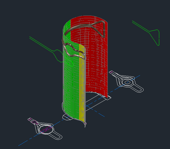

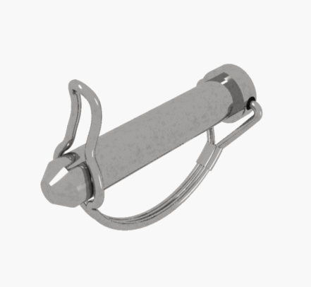

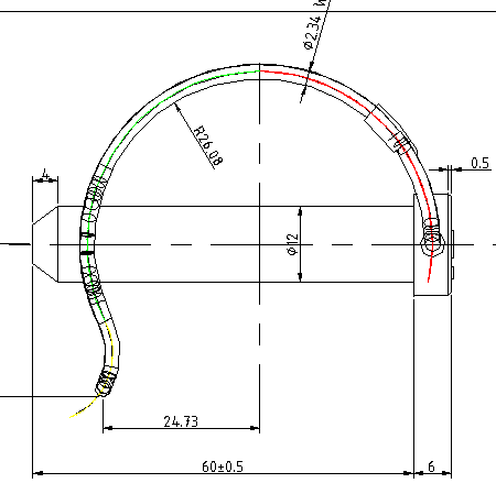

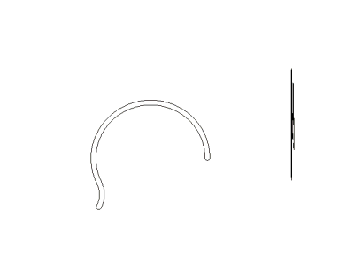

I am really struggling trying to draw the attached pin in 3D autocad.
It is the wire I cannot work out, I am gueassing I need to transfer 2d geomtery onto a 3d plane (attempt shown on a3 attached)? Also bodged attempts shown at a1 and a2 where the incorrect side profile and transitions can be seen. I would really appreciate any guidance on how to do this.

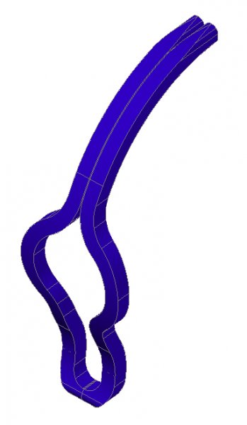

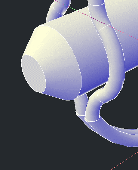

Something more or less along this line? Yeah, I know, it's a hack job but I did not have a lot of time to finesse it.
On second thought, I like this version a little better.
Edited by ReMark

I assume the correct method would be to sweep a circle along a spline path, but creating a complex spline like that is beyond my expertise.
I think ReMark's teaser was done by extruding the profiles to solids in the first sample, and extruding profile centerlines to surfaces, extruding, then sweeping a circle along the surface intersections.

It is the swept path option I have been trying to resolve, the wire is a constant 2.34mm diameter, so as far as I can see the swept path is the only option?

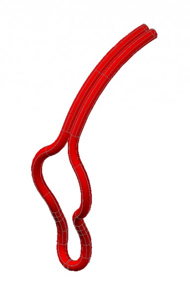

Hi
with the spline, following plofile
in 5min

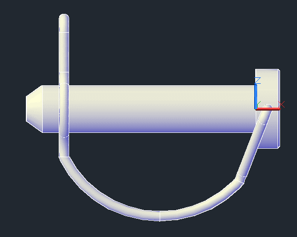

A interesting 3D geometry challenge, especially for AutoCAD. One approach is to construct a 3D spline along the center line using one orthogonal view. then go to another ortho view and with ortho mode set move the control vertices so that they line up in that view. I used splinedit and often changed the ucs to View to control the movement of vertices. When I had a centerline for one half of the geometry I used Sweep to make a solid and then Mirror 3D.

This looks perfect. But I would like to know how you transferred the ARc geometry onto the end features?

I eyeballed the fit points for the spline after I brought the two copies of your engineering drawig into Autocad (the images of course need to be scaled and aligned before creating the spline). In hindsight I should have used your Autocad file and snapped Fit point to the arc yuo created. I just wanted to create something quickly
The process for creating the spline is as follows:
1. Create the spline center line working in one ortho view (e.g. the front view). You can add extra fit point later if you need to.
2. Adjust the fit points as needed working only in the front view plane. Your goal here is to get a good approximation for just the front view.
3. go to an adjacent ortho view (e.g., the right view). Change the ucs so that it is parallel to the view with UCS V.
4. Turn on Ortho mode.
5. Select the spline and drag fit points so that the spline lines up with the geometry for the right view.
This process does take some technique. I find that sometimes I would rather work with CV's (control vertices) rather than fit points. You can switch between the two modes. Use SPLINEDIT Edit-vertex Move. Once you use SPLINEDIT to move Fit points the spline's CVs will appear. A spline goes through a Fit point while CVs are what the database uses to represent a spline. CVs generally do not lie on a spline, except for the first and last CV. The 2nd and next to the last CV point defines the slope of the spline (via the vector from CV 1 to CV 2, and CV n-1 to CV n, where n is the number of CVs). YOu can also use SPLINEDIT to Add vertices and to loosen or tighten curvature between CVs via the Weigh parameter.
In the image below you can see that I used about a dozen CVs.
I hope this helps.
