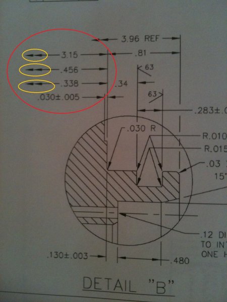

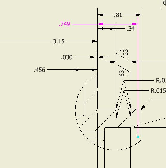

I there a way to make some of the dimensions in a detail view (ones that refer to items OUTSIDE of the detail view) look like this (pic_1)?pic_2.png. I tried enlarging the fence in the parent view, connecting the other dimension extention line to the feature, then closing the fence back to its proper size. I get errors at this point, and the arrowheads don't look like they need to.
Input is highly appreciated.

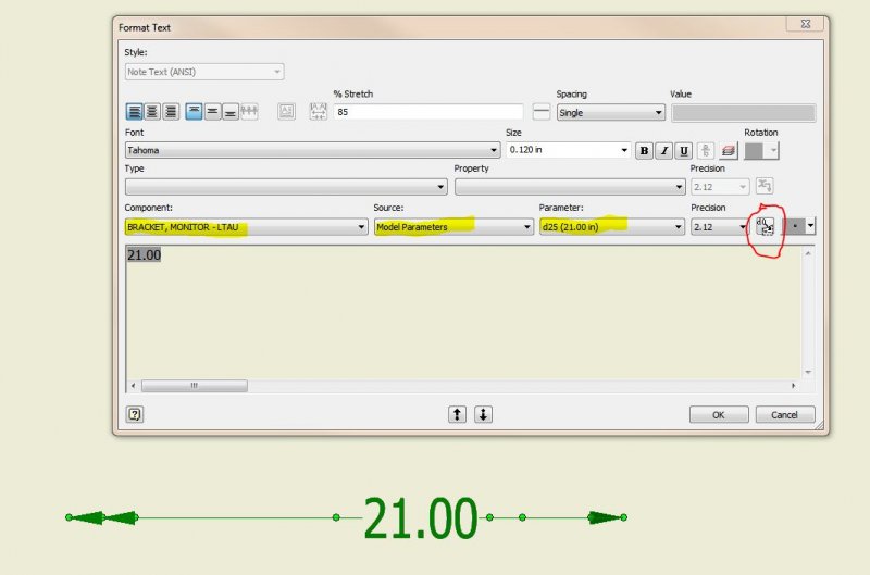

I don't think its possible. You could fake in the dimensions with a leader. For the text use a model parameter as the text source. Then the number would update if the geometry changed. Use Add Leader/Vertex to make the multiple arrowheads.
