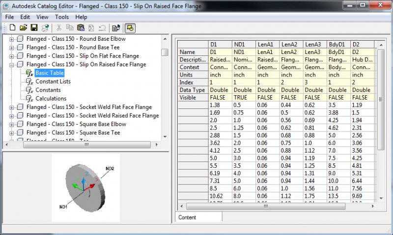

Nope.... for starters, you can't auto-route pipe flanges that look like pipe flanges (ie raised face AND bolt holes) with AMEP. Yeah, I have a silly notion that components in the model should look like their real-world counterpart...

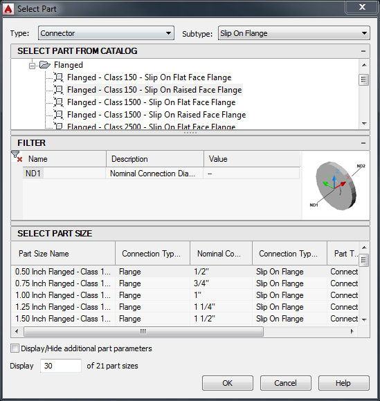

There's a raised face flange in the stock AMEP catalog that's ANSI standard. Have you not found it?
Open it up in the parametric part editor and add some booleans for the bolt holes. You can take it as far as you want but don't tell me it "can't" be done.
And there's nothing silly about you wanting every detail, I agree completely but Autodesk has given you 90% of the part, so just polish it off to your standard and you're done.
Have you tried it? Revolve and Boolean don't work for "Fittings"
No Boolean = no bolt holes = no auto-routing realistically modeled flanges & fittings.
I remember a guy over at TheSwamp.org who got it working a few years back. I haven't tried it, no, because I dropped AutoCAD based applications long ago.

And you're really going to fault a stellar tool for.... "bolt holes"?
Well, I mentioned in my first reply that I need more creative flexibility than AMEP/Revit offers, so yeah, that includes the ability to display bolt holes in flanges. But I've been round-and-round with Autodesk support on other issues and the fact is that the automation in AMEP/Revit simply aren't designed to permit the level of model detail I need in my models.
